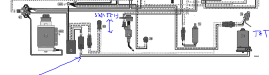

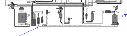

see typical wire diag for t&T motor connection and access to connector from relay box
