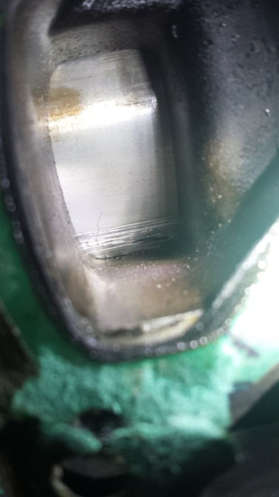

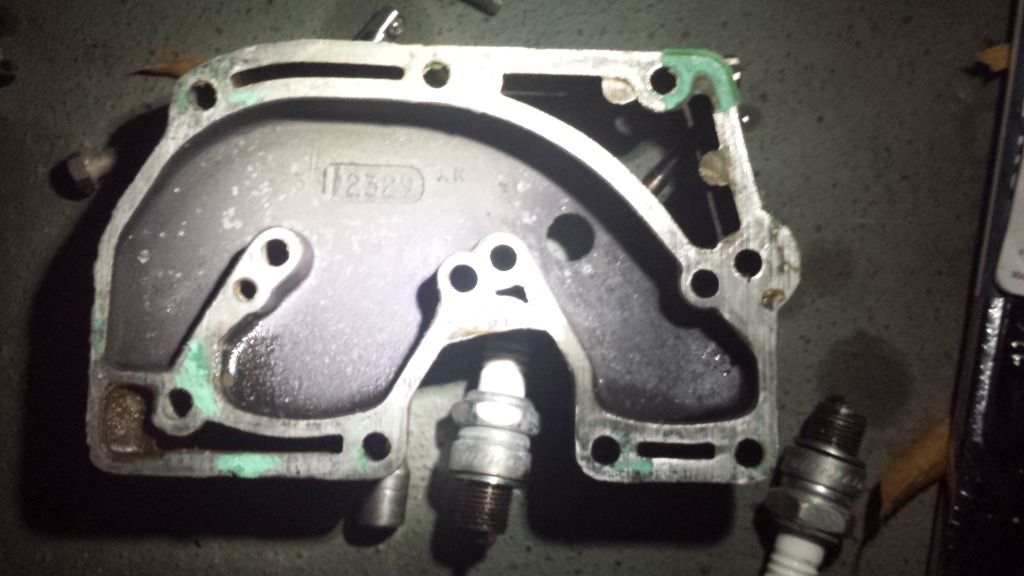

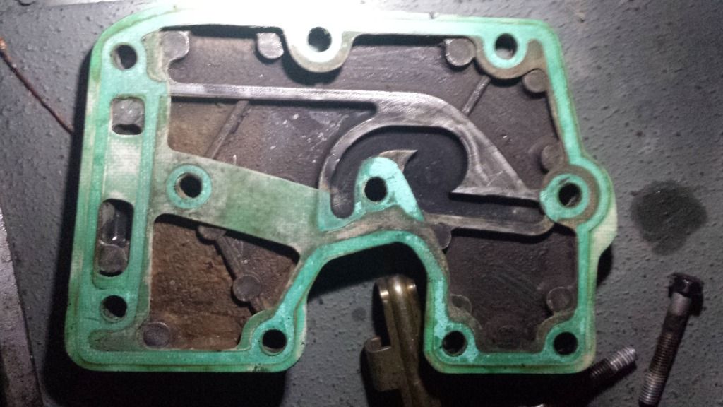

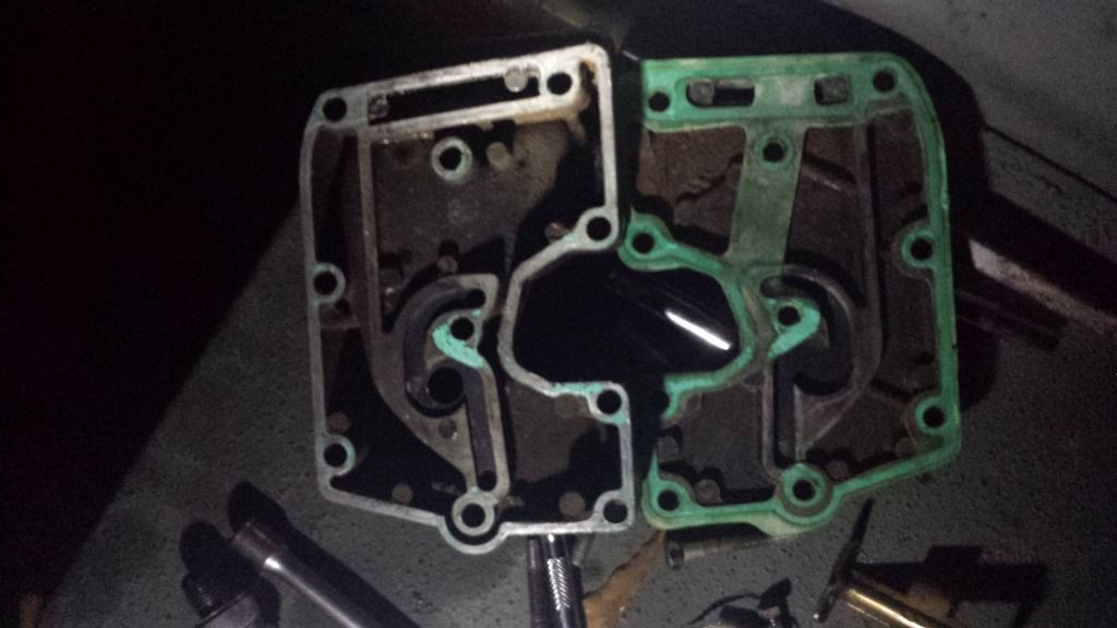

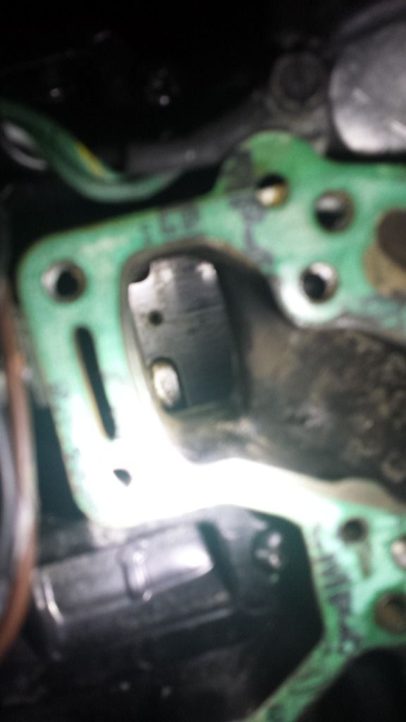

Ok here's the deal. I went to remove the exhaust cover and the bolts were not even hard to loosen. Im not even sure they were torqued down. Next I was looking at the top cover and it appears that the gasket is not correct. Look at the pics and tell me what you think. Also now that I got a look inside I could see water entered both cyls, and the bottom piston is scratched up. It is scratched below the piston rings and slightly on the rings. This was the cyl with the best compression so im at a loss. Water was definitely getting into both cyls because both plugs showed water and corrosion. Ok so here are the pictures. Let me know.

The top cylinder did not appear damaged at all. Also there were no scratches inside the cyl walls. It appears that there are 2 different gaskets(serial group #1 and #2) and it is possible someone order the wrong one.
So any and all help is appreciated.

I personally would tear it down since it's stuck now and you know it's got water in it. You can tell then if you've got rust on your crank or rods, besides getting a look at those pistons and ring grooves. With that much scoring, I think you may have built up enough heat to hang a ring on a port. Even if it didn't break the ring, it could have squenched the lands down on a small section of the rings and prevented that area of the piston from sealing. If I were going to tear it down at all, I'd do it immediately to see if you can prevent any pitting of your crank or rod journals. If that happens, a rebuild could exceed the cost of a good used block or good used motor.

BTW, yes, it appears to me that the gasket was defiinitely wrong. Exposed sealing surfaces with nothing on them with the current gasket. I'm surprised that water didn't kill your spark before the damage was that bad. I guess the water entry was just right to be just wrong. Seems like those motors almost know just how to get boogered up in the worst way possible.

See that your s/n under MISC. PARTS / SERIAL GROUP CHART is a serial group 2 engine. The manifold you are showing in the photos above is a P/N 92329 which is for a serial group 1 engine.
As you have the parts there, you may want to examine both CYLINDER BLOCK AND COVERS (SERIAL GROUP #1) and CYLINDER BLOCK AND COVERS (SERIAL GROUP #2) to see if you have the wrong covers/manifolds and gaskets installed for your s/n.

Ok so it looks like I have a cover and exhaust manifold for a group 1 engine. And a gasket from a group 2 block. This explains why it leaked. Ok now can I use these on my block if I order the proper gaskets, or is there a reason why my block has to have the group 2 manifold and cover. Thanks.
