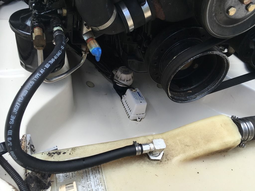

krakatoa
Aug 8, 2008
705
Grab a carburetor cleaner bottle and spray directly into carb while the engine is on, spray on a couple of time while some buddy just hit the choke. My boat had same trouble since it was siting over 4 years as far as I know. I did the anti-siphone valve and yes, it was clugged, I change then the fuel line, watrer fuel separator and replace the anti-siphone valve with a brass valve with no bearing and spring. Now the engine is running fine with no starvation but Im still on muff. Needs to launching and hit the throttle so the carb spit out remaining "dirt" or gump.
Would like to know how your troubleshooting ends and what you did up to date.
here is how the setup looks (pic was before the parts update)
