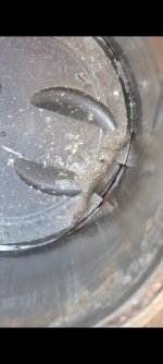

Hey all, I recently bought a boat with a 4.3 mercruiser and blew it up on my first trip on the water....
I have a good 4.3 vortec donor engine.
Looking for recomendations for a good marine cam to get some extra ponies without destroying reliability. Also, will I run into issues with stock rockers running a slightly more aggressive cam?
If I can get my hands on a 4 barrel intake I will go that route as well. I will definitely be doing flat top pistons.

Ayuh,..... Welcome Aboard,..... What vintage is the original motor,.....
Fix the fuel delivery issue, as it looks like you detonated that one to death,....
