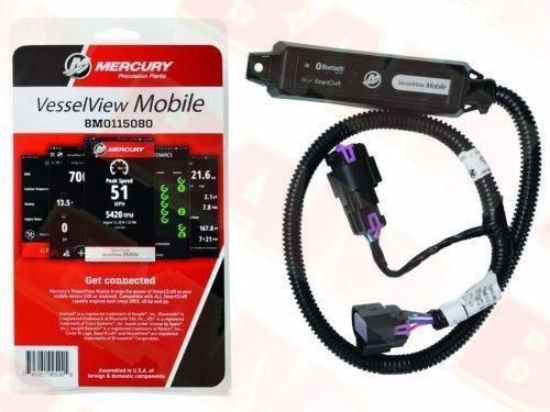

Is this what you are referring to?
QBhoy
Mar 10, 2016
8,348
Fantastic. Any idea to what the name of the adapter is? I'd prefer to order the part now when the vessel view arrives to be safe and if I don't need it I can return it?
@achris will know when and what year the yellow caps were fitted standard from, instead of the old purple weather cap mine had. I’m sure it was from about 2005/06 onwards.
