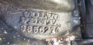

Pics for everything I could find about the engine model are posted.

I have a Volvo Penta 5.0GL that has no power to the positive terminal on the coil.
