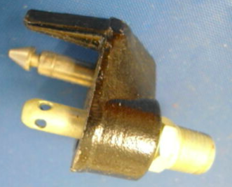

Alright folks......I'm almost ready for reassembly and I have a few issues I need feedback on. The manifold and carb nipples are for 1/8" hose, the Mikuni pump has 1/4" hose nipples, the fuel connector has a 3/8, AND the hole in the cowl plate that the hose has to run through is for at best a 3/16" hose. How do I make all these agree with each other without getting crazy with a bunch of double barb reducers and more and more clamps (for leak points)?

Could I at least clean up the exterior by using a connector like this with a threaded portion and then using a barb to reduce it down to 1/8 hose so could go through one of the cowl holes? Does anyone know if these threaded connectors had NPT threads?

what I have done in a similar situation is I simply added an extra inline filter
which had barbs for 2 sizes it allowed me to connect the fuel source on one side .......then the thinner barb was used to feed the carb . extra filtering won't hurt anyway
as to the pressure out nipple ...... to the mikuni the 1/8 hose can usually slip on the 1/4 nipple with a bit of oil or grease .... warm up the hose to soften it up on the 1/4 nipple
