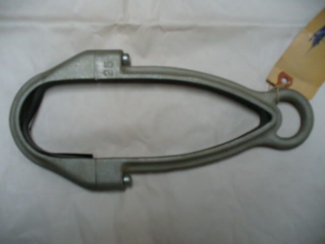

I believe this is the bracket you're talking about:
It doesn't fasten to the leg, only clamps around it. So the holes are still a question.

Re: '54 big twin with pics - to buy or not to buy
i new they had existed,but never seen the tow eye. thanks.
That is the bracket I was talkig about, but I see the mounting bolt's are in a different position than I thought.
