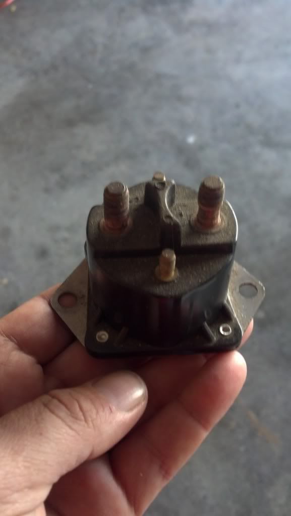

welcome. I bought my first 'adult' boat in Osage Beach, 66 'Twain.
re: trim. on my latest love, I had the same issues and it was a connection on this thingie:
side note - in Lebanon MO, you ran on muffs - WINTERIZE or keep in garage with a heater on the block. Yer gonna get cold again real soon. Lost my 'Twain first winter....
