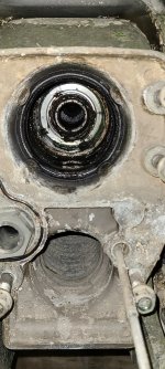

20210613_150357.jpgall seems good in here.
Just need a pointer on where the coupler is located. Is it what connected upper drive to lower drive?
yes, it connects the upper and lower driveshafts
1) boat out of water on trailer or stands
2) remove drive and verify operation by rotating splined input/drive shaft with drive in gear, check for propshaft rotation. if propshaft rotates with drive in FWD and REV then the coupler between the upper and lower is intact
3) with drive off inspect engine coupler which is mounted to engine flywheel
the only time i've seen the driveshaft coupler between the upper/lower in the drive fail is with an underwater strike, seeing as how you lost propulsion while underway my guess is the engine coupler has failed

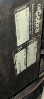

Original outdrive from engine nameplate:
3868386
Sn T00813638
Otudrive thats on it now (mustve been replaced at some point):
3868052
Sn T0779609
Ratio 1.51
