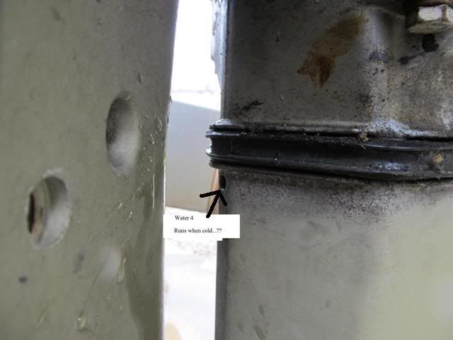

Running on the muff today to clear the fogging oil and test it pre-launch. Lots of water steams make me wonder how and why this system works. Spot #4 sems to only flow when cold. Had to remove a 2 pc exhaust cover to see what was happeing under it. Perhaps it is not supposed to flow once the stat opens up...???

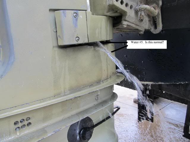

These pics show the engine idling and a low flow of water from the hose. My biggest concern is the flow at pt#5. Is this normal or has a seal gone bad? Looks the same on port side. I have the OEM manual but not a lot of detail on the cooling system. Motor has no tell-tale but I'm thinking about adding one using the Top Secret Files.
Any thoughts? Thanks.

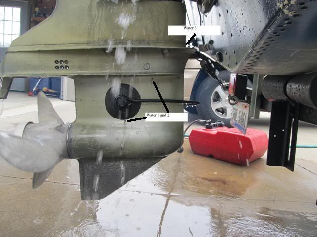

Here is a pic of my old '95 Evinrude 60 running. 1&2 are weep holes that drain the area below the water pump. 3&5 are weep holes that helps drain the area between the inner and outer housings. Can't quite make out where 4 is located.
Yours looks normal. Any overheating problems? Should be able to keep your finger on the head for a count of three.

#4 is the highest of the points. I had to remove the cover plates just below the lower motor cowling to see it. I don't think I have an overheating problem based on the driveway test (low RPM, no load, etc.). Again, just wondering how these systems are supposed to work.

Still looking for advice.......I'd be happy to run more tests if anyone has recommendations. Since my concern was a the "swivel" (point 5) I should check to see if the water is warm, that would mean it's run through the powerhead.
