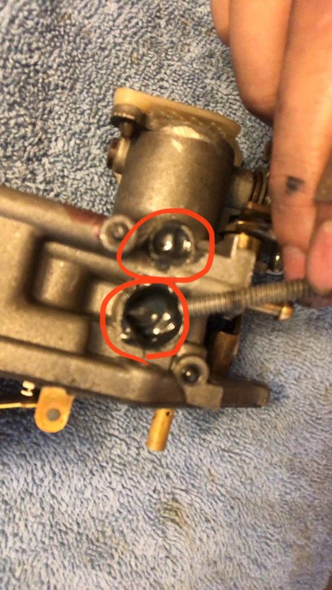

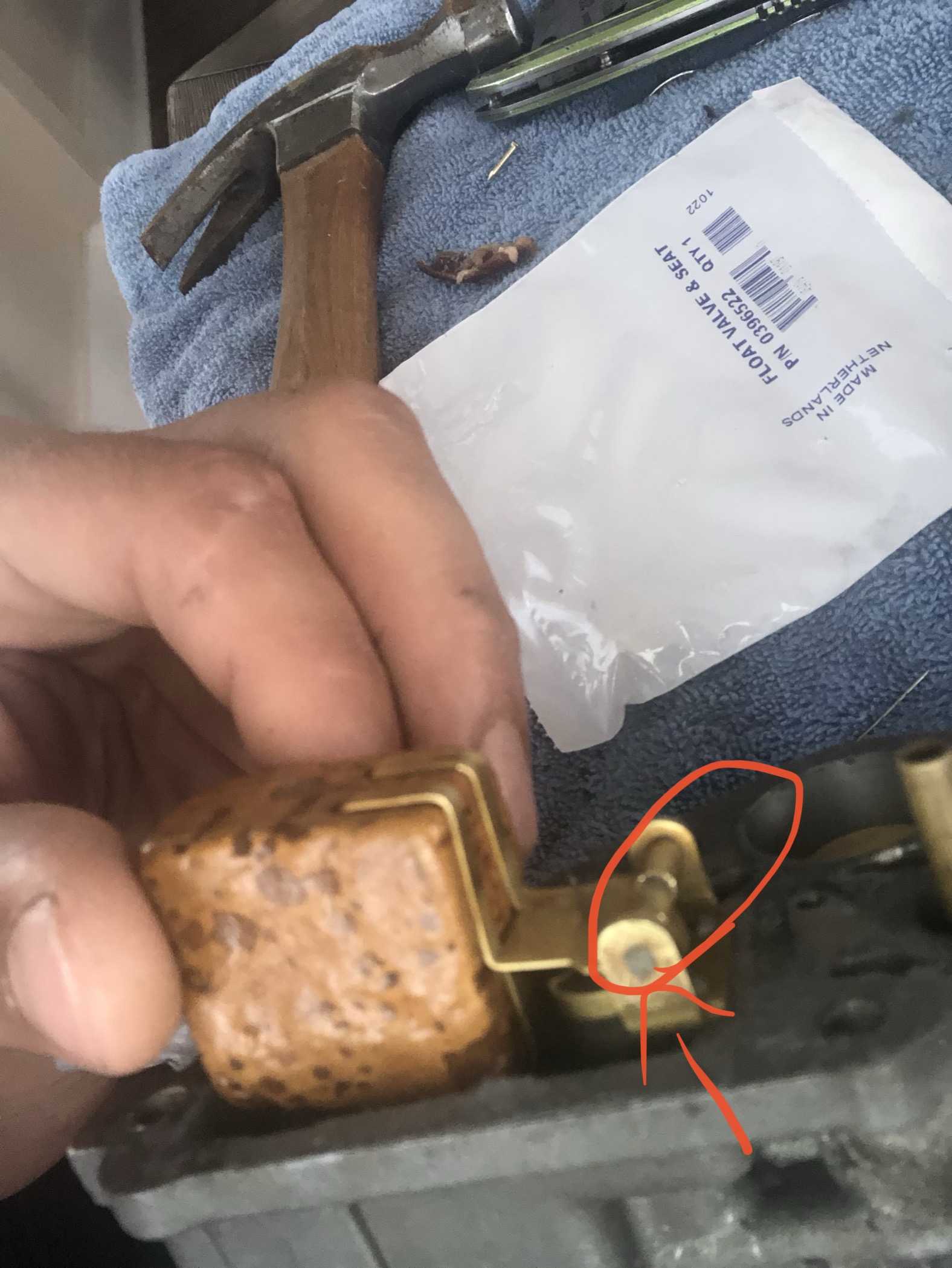

Okay guys I found the issue, carb float is so Gunked up it will not move by gravity, also found that the two plug holes are jb welded shut opposed to putting proper plugs that come in rebuild kit (currently rebuilding) any ideas on how to remove the jb weld? I have a hole through the smaller hole of the jb weld, however the bigger hole the jb weld made its way down into the hole before sealing, I do not want to drill and damage carb. Maybe try sanding it out?

Here are the images of the jb weld filled holes and also the float pin I’m having issues with, I Started to use a Stengel to drill a hole and then work off but I do not know how deep these holes are (not wanting to damage carb).
jb weld over plug hole

Stuck float pin
http://u.cubeupload.com/Boatman1997/F211E0277B9A4EB39884.jpeg

Hey guys recently picked up this 73 9.5 sea horse and was having fuel/carb issues, so I tore the carb apart after purchasing a rebuild kit. What I found was the two core plugs had been filled in with what looks like jb weld, I also found the float gummed up and hard to move. What I am asking is solutions of how to remove the jb weld, and how to remove the float pin. I added some links of what I’m dealing with to paint a better picture.
I started using a dremel to try and drill a hole in the jb weld, I succeeded on the small hole, however I stopped on the larger plug because unlike the smaller hole it was not flush with the carb body it is sitting down about 1/4” into the core plug hole.
core plug holes (used for cleaning out slow speed orifice holes) with jb weld -
http://u.cubeupload.com/Boatman1997/6B5DC312E52E472CA878.jpeg

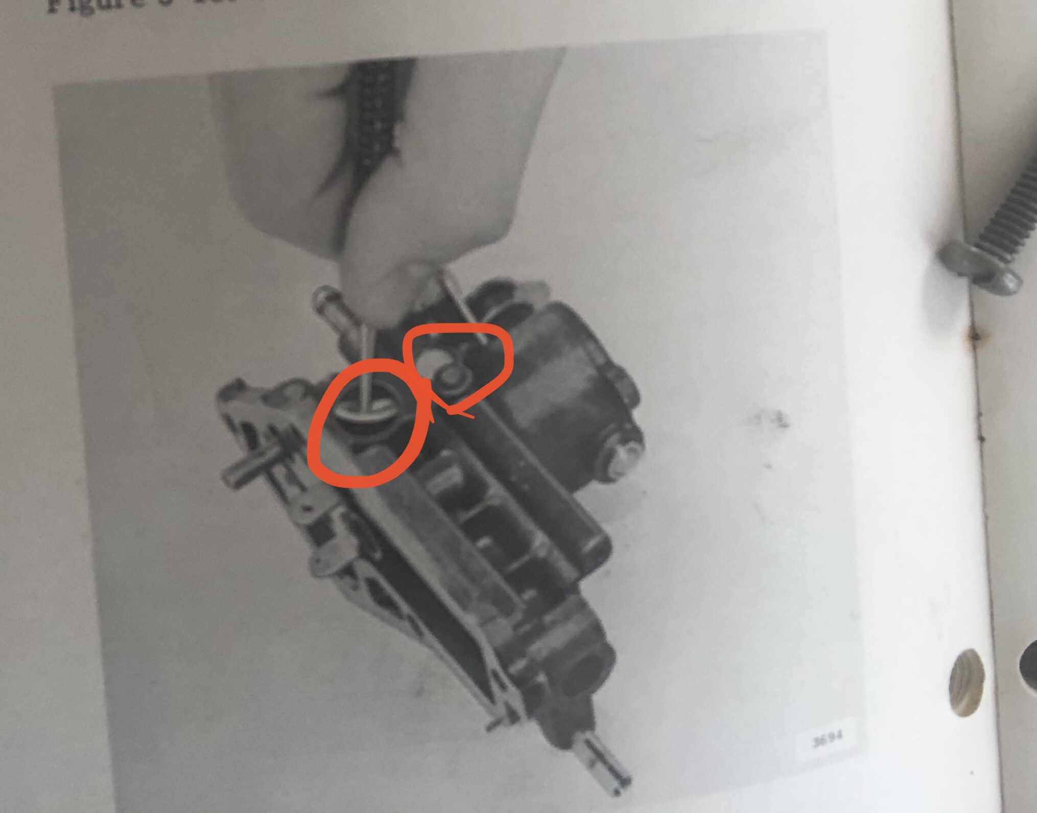

factory image -
http://u.cubeupload.com/Boatman1997/E8FFEF8E68E94B1190D2.jpeg
stuck float pin-
