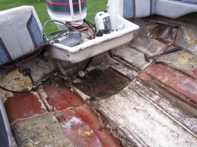

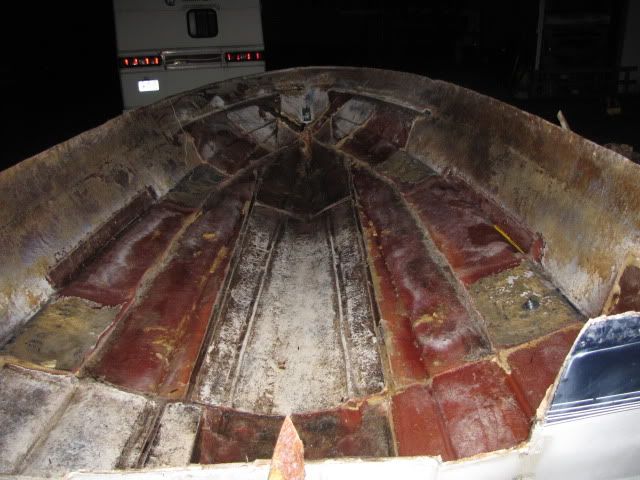

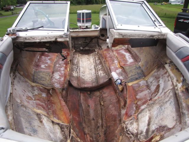

i bought this boat last week, thought i was gettin a good deal. took it for a test drive and it drove good and scooted right along. it had the original back to back seats in it and planned on tearing them out and putting in a pair of pedastals to open up a little floor space. well i started that project the day after getting it home. found out the floor was rotted. ok no big deal, i'll just redeck it. didn't plan on redoing the bow, once i got up there and seen what the previous owner had done it had to come out to. he had laid plywood over all the original stuff. had 4x4's all over bracing everything, foam was totally saturated. so it all came out, today i got to looking at the transom and of course that's gotta come out to. i'm going to work on getting the cap off tomorrow after work. the good news is that this thing should fly when it's all done as it'll be 1,000 lb's lighter.
i didn't think of taking pic's until today, but here they are.

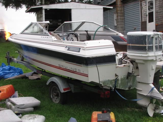

well i didn't get as much done today as i had hoped. wife had a couple of things for me to do when i got home. i got alot of stuff cut back and started grinding away at stuff. didn't get alot ground down when the backing plate for my sanding disc grenaded, that put a end to that for tonight. hopefully it'll be totally ground down tomorrow. i gotta get me some resin and epoxy pretty quick so i can stay movin. it's going to get interesting soon as this will be the first time i've ever messed with fiberglass. anybody think i can have this thing back into the water by the fourth?
dorelse, do ya mind tellin me where you got that rear bench seat. i would love to set the rear of this boat up this way. sure looks easier to get back into the boat, and it would get the kids ear's a lil farther away from the engine. thanks.
on edit, i forgot to post my pic's. it was gettin dark so the pic's aren't that great.
