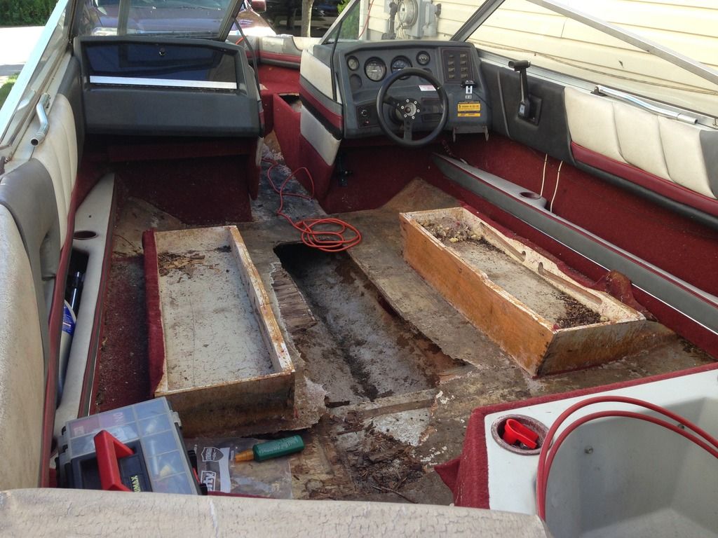

further
Jun 18, 2009
1,034
Yep you probably have something similar to the boxes shown in this photo.
It's a maxim but similar in construction to bay liners. Sawzall with a flexible blade.... Just be mindful of where you're cutting so you don't cut into the hull.
