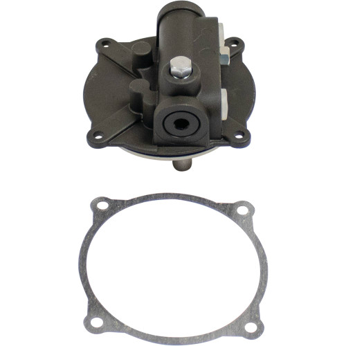

(Valve Body)

My tilt trim was doing exactly the same thing as yours. You can coax it up but bleeds off internally. I bought a new pump assembly complete for 150 bones and it now works perfectly. When I removed mine there was alot of metal shaving paste around the top of pump. I suggest you use some ultra black permatex when replacing around the new oring and ensure your 4 screws securing the pump are in good shape or you can join me in doing things twice!!
