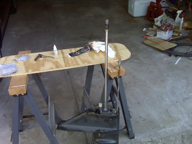

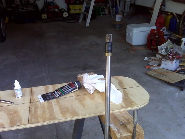

I still have my engine apart right now so I'll take a pic or two when I get home tomorrow. Hopefully it will help you.

Sorry it's taking so long, but I'll post that pic tomorrow. Been super busy.

Re: 88 force 50hp impellar related/seal question
Seal is at the top of shaft.

Nice photos, Thanks for the help, Very helpful!
