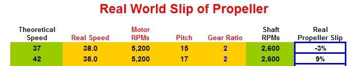

Now to get back to the corret prop for your boat, my program shows a 15" pith prop is what you should have on it and it appears to be turning in the top 6% of recommended RPM.
But for you to be getting 38MPH out of a true 15" prop with a 2:1 gear ratio at 5,200 RPM is impossible. That is showing a negative slip of -3% and that is not possible.
There are 3 things that could be happening to show those numbers:
1. The engine is turning more than 5,200 RPM
2. The prop has a theoretical pitch of about 17" and thus the prop slip
is actually +9%
3. You forgot the speed it was going when you did the tests
To get the most speed out of your boat I would raise the motor up at least one hole and see what the RPM are at that time and see if the prop is ventilating too bad. You don't want to move it so high that it ventilates easily in turns, because when you get in rough water you will have to be giving it gas and letting off as the waves harm your speed by ventilation, by slowing it down or speeding it up depending on which way they are going. If that works move it up another hole and test it. That is my recommendation.
