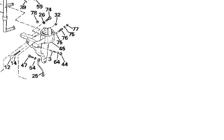

Update.... I got home and it was still light and the hose was not frozen so I started it up and tried to adjust the low speed needle and that really did not help... While I was looking at it good I see that I need to take the electric starter off to get the carb off and I can't for the life of me see how it comes off and the SELOC manual really did not help. So any help would be appreciated.
jasper60103
Sep 18, 2008
2,055
Re: 89 25 Evinrude idle a little rough
See bolt #74 and nut #44
I have taken those two loose but it is still on there tight it seems there is another bolt holding but I cant see it
