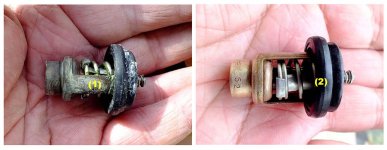

If the motor has not been internally desalted from new, that's the problem. It's not cooling as it should, too much crude, salt formation on the entire water passages and the overheat sensor triggering prematurely. With more use will get worse....check same issue : https://forums.iboats.com/threads/why-is-the-ob-overheating.740657/

Sea Rider, The motor has been flushed consistently throughout its life. Earlier years (not owned by me) was in fresh water. Based on your response, I assume the exhaust chamber cover needs to be remove and internal passages cleaned. Would the head need to be removed as well? I also wonder how many of the bolts will cooperate and come out. They have been in place since new.

When you clean all the water passages need to tear the cylinder head, exhaust cover, thermo housing and powerhead from it's base. Will need to manually scrape with a wooden sushi stick all the filth found in all those mentioned water passages. The issue is that any bolt highly salted can break when removing, you've got only 2 alternatives, take the risk and go that way or keep overheating eternally and missing the boating fun at speed.
I'm the only one here recommending this cleaning procedure which been doing for years now with different HP motors. Pics 1-3-4-8 corresponds to a motor with 500 clocked worked hours in salt water and near daily use, was flushed on muffs for at least 10 minutes after returning home from new. Pics speaks for themselves. Now cleaned to perfection as a preventive internal maintenance running as an Olympic champ...
None of the parts that you have thrown into your motor were needed after all the water passages were cleaned to mint clean condition (Pics 5-7)

To tear such parts it's not rocket science, try to find someone experienced that can remove those parts for you at your home, will need to manually clean/scrape off all the water passages filth to immaculate clean cond. A gasket set only costs $ 74.00, torque all gaskets to specs, put powerhead back on pan and that's it.
Take advantage to decarbon the exhaust cover, piston heads and cylinder head as well as seen in pic 5. Will have a motor cooling and running properly as when out of the box for years to come.
