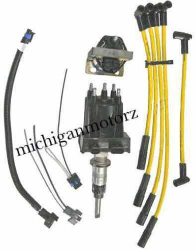

You need a Delco Voyager EST distributor unless you want a setup less reliable than points ( which are very reliable ).
Pertronix has been known to leave people paddling. The Delco Voyager distributors are great except there’s a small issue that the timing advance is based around newer motors as the cylinder heads changed and the older motors take a little more advance. You might loose a little power
