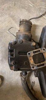

I do not have a ton of experience of physically working on engines until now.. I do part-way understand how most things work.. I have already bought the exhaust manifolds & thinking I may need new risers as well(on for sale ad, why I am part-way interested). I will attach pictures of my old risers as well so that my help can have an idea on where I am at..
(PARTS LIST): I currently have down that I will need:
•I did buy some exhaust
•Already bought a pair of exhaust manifolds(factory basically, but would have considered better ones if I would have known prior the difference better ones would have possibly made).
•I am interested in some new risers because mine are a little rough(pic attached) and also i have heard a lot on how much the risers can help with performance..? I can see that on the pricing as well... lol but risers are on the parts for sale list, along w many others: which is where a lot of my handwritten questions marks came from.. I will also attach my Engine Specs as well.
•The parts for sale list also has a a single holler double pump 750 CF carb better than my original carb(pictured in attachments) if I rebuilt it?
