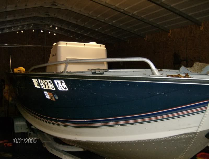

This is a 1989 Starcraft Mariner 210. It?s a 21 footer and it?s set up for an outboard. As you can see it?s a little rough on the inside and the top but the hull is in good condition. Here?s a shot still hooked up to the truck. Note the big honkin console I picked up from a guy in the same area. It?s from a storm damaged 06 Sea Hunt center console. It?s about 15 inches taller than the stock one but the width is the same and it?s much nicer so I think we may use it.
Here?s another side view.

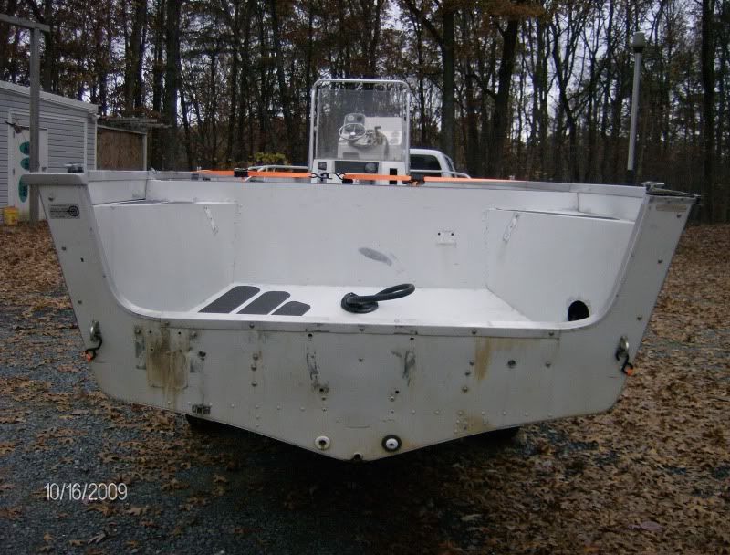

Here?s a shot of the stern. The transom?s bone dry so I lucked out on my second boat and don?t have to replace it.

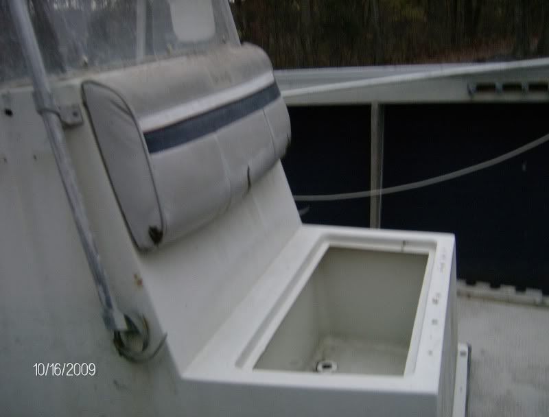

Here?s a shot of the console along with a spare cowl I found to go with the power plant I purchased last week. More on that later.

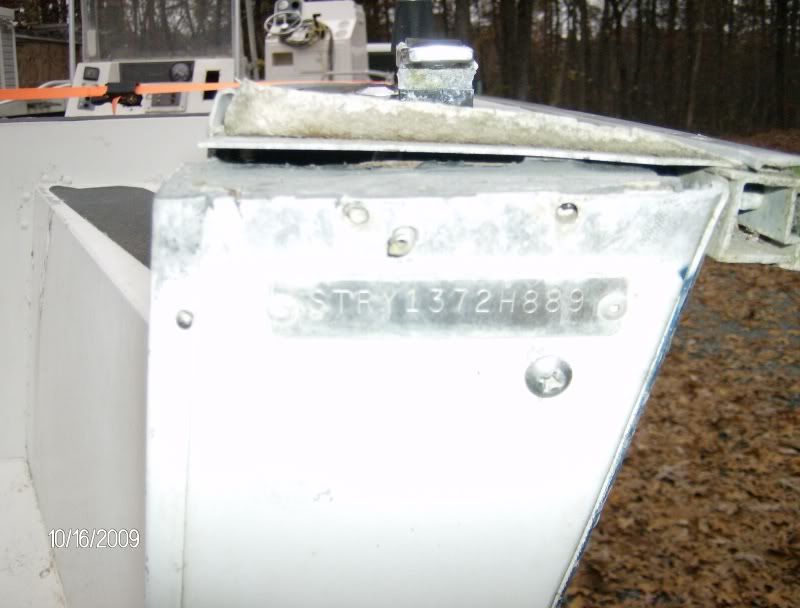

Here?s a shot of the missing corner casting. Rumour has it I can still purchase these from Starcraft.
Another shot of the stock console.

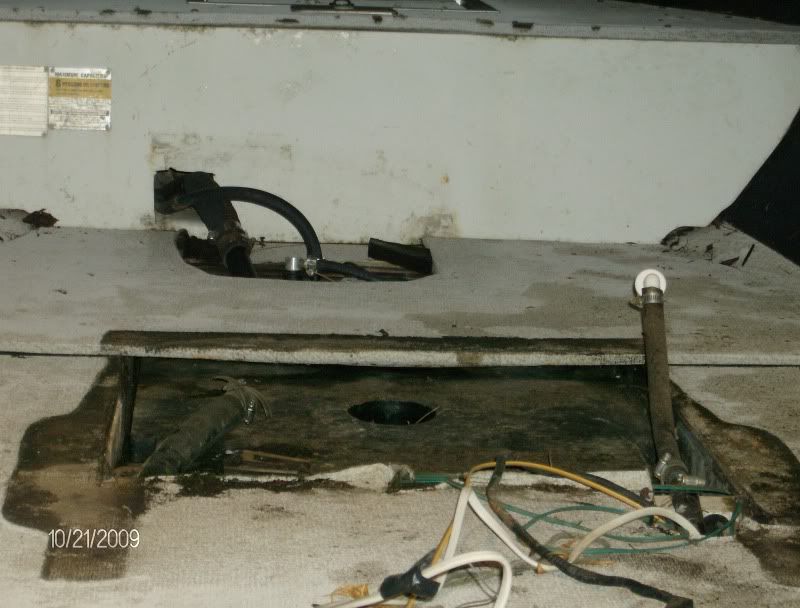

This photo shows the soon to be replaced foreward casting area along with what I think is some kind of PO installed custom belly tank.

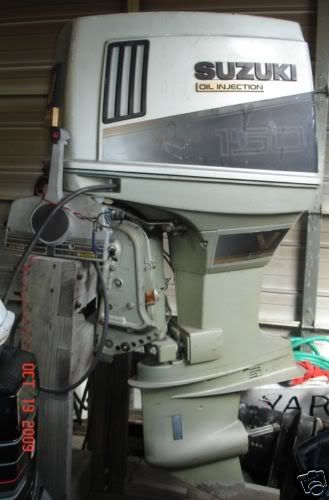

And last is a shot of the motor. This is an 86 Suzuki oil injected 2 stroke 150 HP Super Six. It's got tilt and trim and compression checks out accross the board. Should make this fishin machine scoot along pretty good.

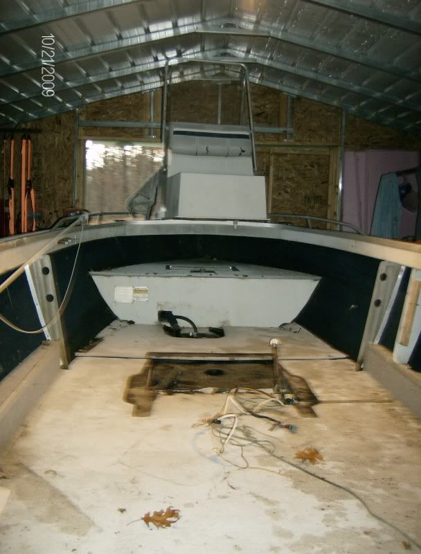

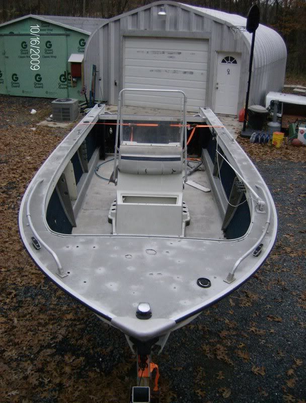

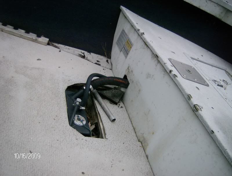

OK, we got a few spare moments today so I went out to the boatel and yanked all the trash and the stock console out of the boat. This will give you an idea of what's going on here. Looks like maybe the PO had some sort of fuel tank issue and installed this new one. complete with it sticking up thru the deck. to facilitate this install they just yanked the floor decking up and overlaid it on the lower peices of deck. To get the console back in they screwed down three peices of pressure treated blocking with shims under the two side peices and screwed the console to that ???? A real hatchet job!
Here's a close up showing the overlain decking, the custom fuel tank installation and the outline of the PT lumber.
So we yanked it out and heaved the new big honkin console in just to see what it looks like.
Continued due to too many pictures:)

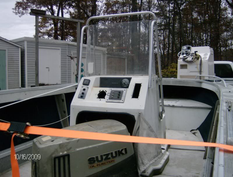

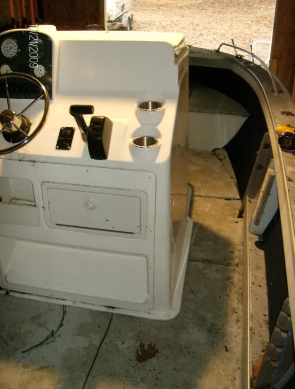

So here are the photos with the new console in place. I need some honest opinions here folks! Is it too big? Don't forget, it still gets a small windshield and grab bars.

I can see why you asked......but I don't think the console is too big.

I am new so not an expert yet , But just looking at the initilal view from a laymans view..
It looks to big for the Boat ..

Well it doesn't look too tall.... well not as tall as I thought it would from what it looked like in the back of your truck. But then again you know I will be a bit biased :D because I need the old one. But really it doesn't look as tall as I originally thought. But now that other pic thats another story there.:eek:
