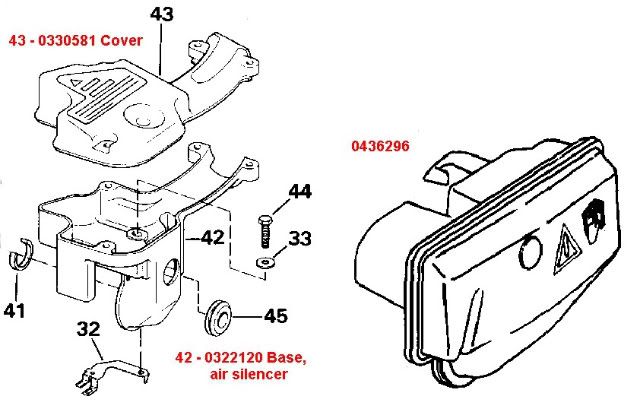

The part # in that eBay auction is for a 1993-2001 9.9 and 15 motors (and a few later ones) ... and it's only about $18 brand new. Your 1986 air silencer is 2-part (base and cover), and it's a completely different shape.
Here they both are:

Giving the dealer a call is a good idea. You need the silencer and all the other parts shown. There is about four screw bolts. So with out the silencer is your choke lever bouncing off the carb. connection point? My recollection is the silencer parts is what holds the choke lever in place. Rick.

Rick - No, luckily the metal choke lever on the carburetor holds the plastic choke push/pull control on one end and the hole in the front fascia of the motor holds the other. Looking at the diagram, it looks like the lever passes clean through the silencer.
