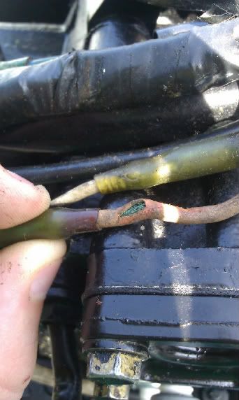

Edit: I just discovered something interesting:
See that frayed wire? (duh) That's coming from the temperature sender. It was facing upside down, possibly grounding to the engine block. In the middle of writing this, I thought to go back outside, purposely ground it and see if the buzzer would go off. I didn't turn the engine on, just turned the key to on. I touched the frayed part to that exposed bolt where it was resting near initially and bingo. The buzzer went off just as it had before. So, I may have found the problem. But I would still like an expert's opinion before I try to replace that wire.

Bump for expert opinion about if I'm good to go or not after I patch that wire. Also edited first post.

Looks like you've found your issue, congrats. I am no expert like I said earlier but I would put money on it that the frayed wire is causing that.
