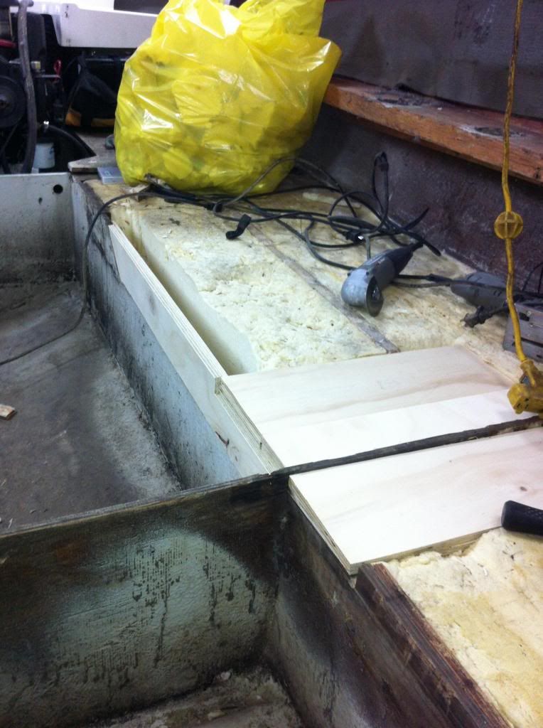

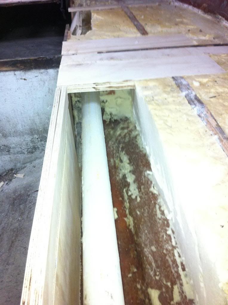

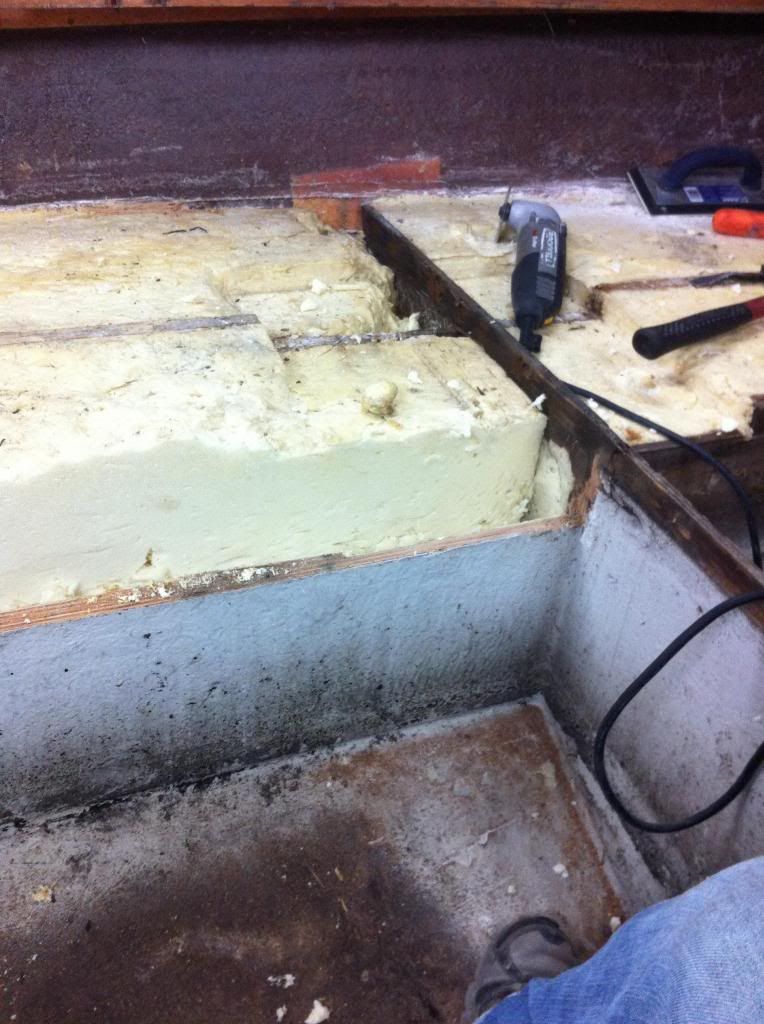

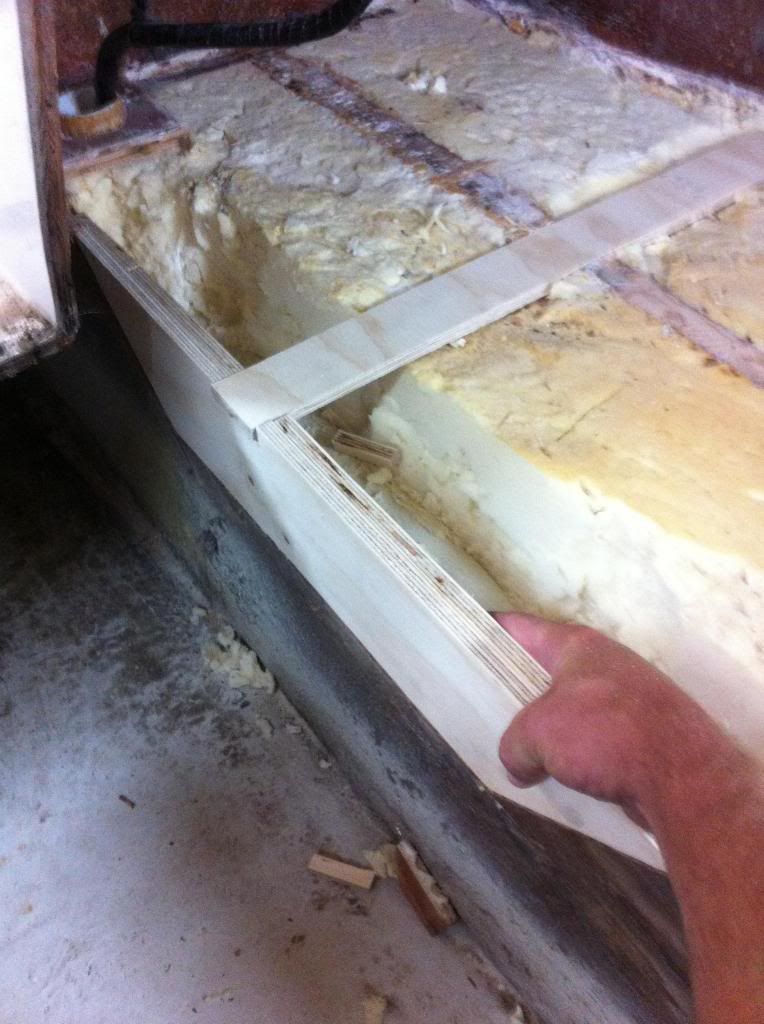

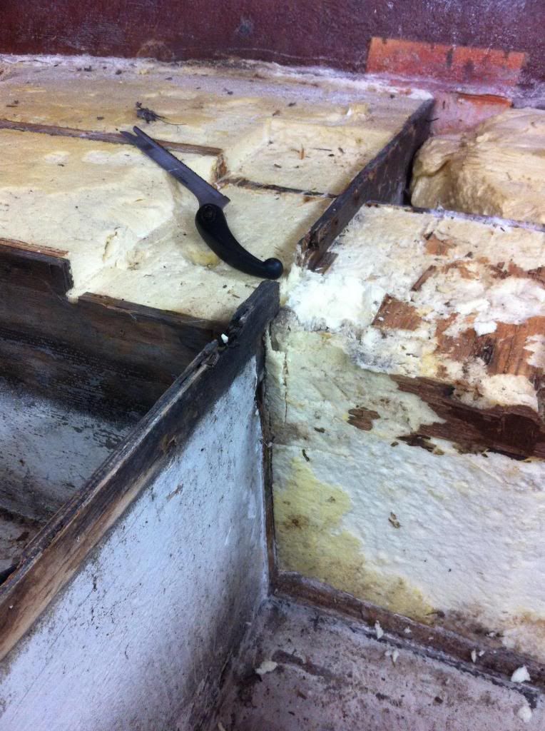

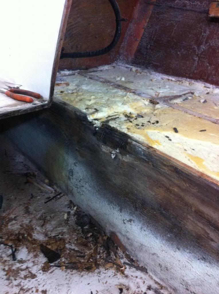

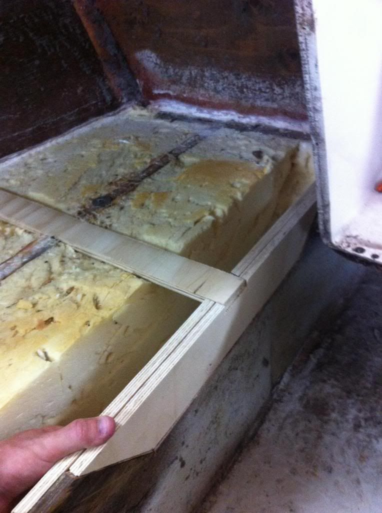

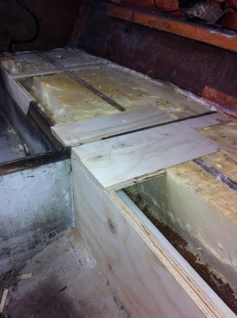

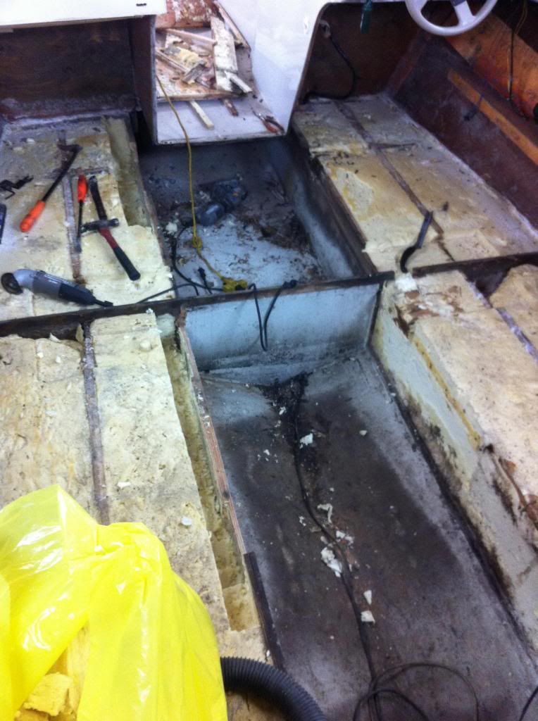

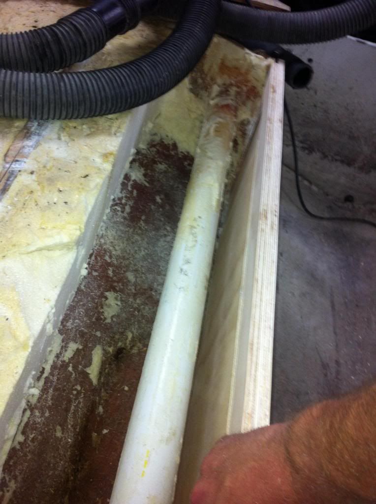

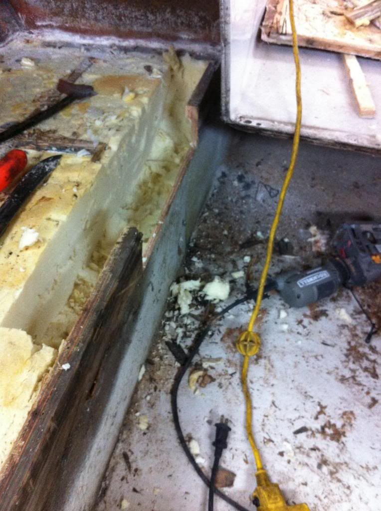

After a bunch of reading and some free time I am finally getting started with my restore project. I have the decking removed and the rotten stringers out. Pictures are below:

Now for the questions:
There are a few small spots where wood rot started and I am trying to not turn this thing into an entire stringer rebuild. Can I use CPES or is there something else to treat these spots?
With the wood cut and ready to be reinstalled is the right process to grind and clean all the bonding surfaces, pretreat the wood with Resin, install stringers in PB, coat with one layer of CSM, then a layer or 2 of 1708? Can I use CSM instead of the 1708?
As you can see in the photos I did not have to pull too much of the foam out 3" or so to the side so I had room to work. Do I need to use the pour in foam or can I just use exterior window and door foam?
on the decking I did not get to see exactly how the old deck was installed due to some previous repair being done. my question is this...do you normally cover the gas tank? I can see where this would be huge in keeping water out vs. having an access area but want to be sure. the Fuel cell area is 5' long so too long to lay a sheet across the boat and hit the cross stringer. I could lay two down each side and have a seam all the way around the fuel cell glassing in that seam and then use a full sheet for where the captain’s chairs and walk thru is.

Re: 95 FW 240 Horizon Restore
Also I would like to know any good ideas to get a template for the decking. I bought some 1/2 foam board that I could cut easily, move around easily, and be less costly if I mess up. For the decking I was planning to put back 1/2 sanded pine that has the outdoor glue. I did think about bumping up to 5/8 or 3/4 but the 1/2 will match the decking in the rear of the boat that I did not have to remove. I also thought the foam would help with any flexing since it is setting directly on the stringers and foam.
Thanks WOG! I am getting a little antsy as I am planning to do 5 hours of work tonight so I want to make sure I am on the right track.
Any feedback on how I should do the deck layout and specifically how I deal with the gas tank area? Do I build a removable cover or just lay over the tank and cut into it if I have to down the road? Pics above should help.
Additionally there are a few small spots where wood rot started and I am trying to not turn this thing into an entire stringer rebuild. Can I use CPES or is there something else to treat these spots?
CPES is worthless IMHO. All wet Rotting wood should be replaced. It cannot be repaired. I would replace the Deck the same way that it was. I really don't see a need for a hatch. If you ensure that the tank is clean and all the internals are working correctly or better yet replace them now while you can, then I see no reason for having easy access to it. After to replace the deck in a proper fashion, if you maintain the boat well, and keep it out of the elements, the deck and everything below should remained sealed for decades. The Foam in a Can is of no value and should not be used in my opinion. I would use the Blue or Pink slab foam from Lowe's and cut it to fit the areas needed. Seeing how you are scabbing in your pieces I would Highly recommend that you use Epoxy for your rebuild. You will need the added strength that it provides. If you decide to use it then you will not require Fiberglass mat, only Cloth. I'd use 17 or 18 oz biaxial weave.
My heart sunk a little tonight. After some good advice from the forum and WOG I was well on my way to repair but little did I know I was on the RIVER OF DENIAL. As you can tell above I am into my project already and thought I was ready to start with the decking, in fact I just fitted and cut the front most part for the decking and man I must say it was easy, 30 min or less, thanks WOG!
After that went well I felt a little guilty and thought hey why not take a few more samples and lets really go after the trouble areas at the BOTTOM of the stringers. It was a good idea with bad results. I started removing foam and it looked ok. Most had less than 1/2" of water in the foam and some with nothing at all.
Let's dig further into the wood in the gas tank area and sure enough a wet stringer. Wood was still solid but wet and that means rot in the future. I moved forward past the bulkhead and again wet wood. Oh no! I then moved past the walk way which really should not have much water and again wet wood. Oh $@&?! now I am in trouble. I have a 24' boat that needs a lot of TLC.
