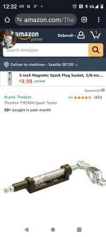

compression is 100 +- 5 psi, I heard the were low compression motors, I just put new plugs in, I think is being flooded with fuel, or the power pack is week, the idle screws on half the carbs has no effect on it. I started pulling plug wires, its running on 3 cylinders. I have a spark tester, the type in a plastic housing, will it do? I've seen the clip-on type, after all the money I've spent, before I tell my wife, I'll run it like it is the rest of this season. lol

You need a spark jump tester....pick up one of these cheapies and look for a "zap" of 7/16, nice and blue.
As for the wife, we all have our secret ways! 🤣
