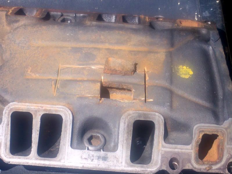

I have one piece exhaust manifolds. Pulled manifolds, no sign of water leaks. Pulled intake and heads hoping for blown head gasket. Found nothing obvious. :mad: Now suspect cracked block.
Read the FAQ on this site about water in oil. Inspected block, saw no cracks.

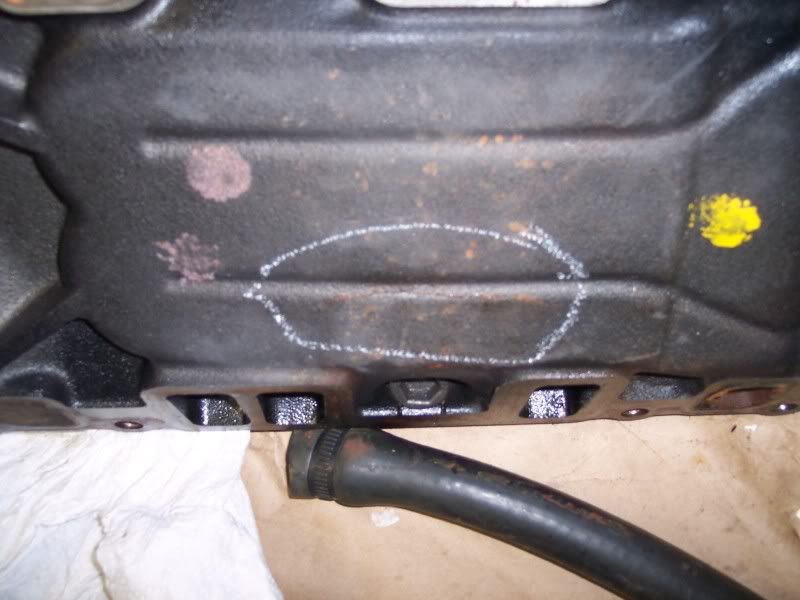

Cleaned goop off heads and intake. Found crack in intake. I drained the block and manifolds last fall the same way I've done the last 13 years.
Was this freeze damage? Doesn't seem like a place water would be trapped, too high on the engine.

Could be freeze damage, are you sure that's were the water was coming from.
maddog82
Jun 10, 2009
7
Re: 97 4.3L Water In Oil Caused By Cracked Intake Manifold
Freeze damage for sure.
