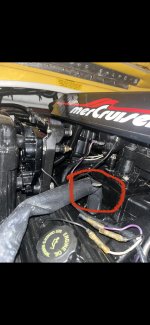

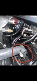

1998 mercruiser 5.7 . I noticed this wire with male disconnect not attach to anything . Is this just an extra wire from the harness for a different engine setup ? Or am I missing something next to the ignition module and carb .

Tag end ground primary for something. Harnesses were mass produced for multiple packages, not uncommon to see/find these type primary grounds
Think staircase to dead end in an old tyme rich persons house.
If all is sound with operation it's okay to disregard said wire end

I'd be more concerned with the collapsed / crimped hose beneath it.

All normal...The extra ground clip shown is for a different style ground connection for the choke of the carburetor vs the round style you have on your choke.
