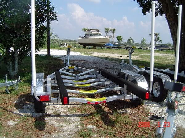

My trailer looks like this in the rear:
Notice, no transom tie down hooks... Rather than wrap my tiedowns around the frame everytime, I'd like to install some eye hooks for easier tie down attachment.
If I attach something like this:
#1: Will it be safe or will it compromise the trailer's structure?
#2: Since the trailer is aluminum, what is the best material for these eye-bolts to be made from? (Zinc coated, forged ?, any?)
Any other ideas? I've looked for something that will clamp onto the trailer rather than be drilled through it but can't find anything quite right.

The picture shows an eye in it already. Right above the tail light. Its facing fore-aft so is aligned with the view, but its there. Look at the trailer next to it, just above the bow stop in the foreground and you can see it.
Also, its an I-beam trailer, so if you want one in another spot, just drill a hole and stick one in there. Its not like a box beam trailer where you can't get to the nut on the back side.

The eye thats already there is not going to work for my boat. My transom tie down eyes on that back of the boat are far more centered under the swim platform.

Have you checked around with local fabricating/welding shops to see what they would charge to weld a couple tabs on? Might be worth a call or two. I couldn?t pull up the image, but I?m sure it could be done.
My SWAG opinion is that a hole drilled through aluminum with anything harder than aluminum through it will eventually round out the hole and come loose. Also, I-beams are meant to have all of their force applied top and bottom, not to the rib. I would think that altering this approach could result in failure during a crash.

For some reason, the link no longer works - Here's another pic thats close to mine. I cant get any actual pics of mine until Monday, cause the boat's still in Florida til then.
