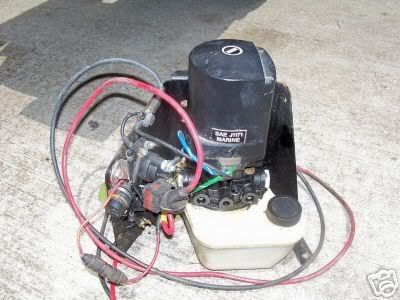

my reservoir had a crack in it. It was stock, somebody over tightened the screw that holds the reservoir to the pump. SO a few vibrations, nasty wake's and misceleneous bouncing caused the reservoir to split on the bottom.
this is what the assembly looks like.

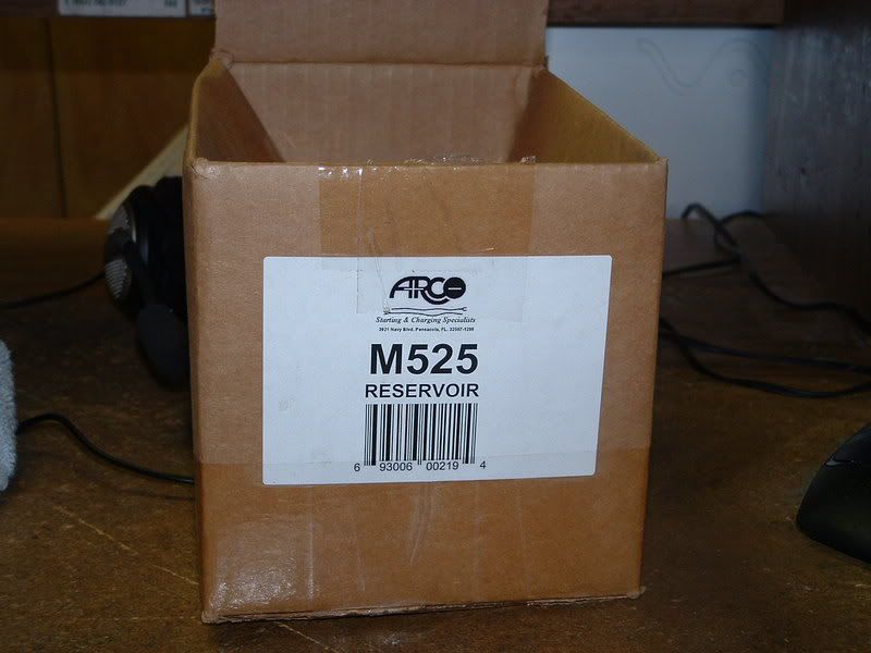

here is what I have now for a replacement.
well heres the box, i pitched the old resevoir.
i have this resevoir from arco as a exact replacement

That one looks exactly like mine.
