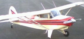

OK, quick side track- EAA's magazine, Feb. 2000 I think. Interviewed by a guy I revered at Oshkosh (Bud Davison). I had already read nearly every word he had written. When he walked up to me and asked if I had a minute, just a few minutes after tying the plane down after arriving, I thought I had done something wrong.... -Al
WrenchMike
Oct 24, 2020
9
That is pretty cool. I had a guy come up to me in a hurry after tying down once. I thought he was seeing if I (or the plane) was ok after the landing I’m sure he witnessed. He just wanted to talk about the plane. I always wanted to go to Oshkosh but never made it. Beautiful Pacer!
ahicks
Sep 16, 2013
3,957
Thank you! That was serial #180, one of the earliest Tri-Pacers. There were only a couple older that were still registered. God only knows what kind of shape they were in! -Al
