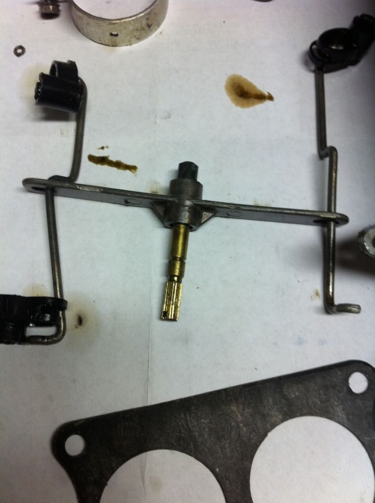

A question regarding the updated red needle retainers:
When removing the assembly connecting the needles seen below. The low speed adjustment dial on the outside of the engine is obsolete as well. Correct. So after the carbs are on the only thing to re-attach is the air silencer?
