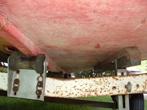

I searched for old posts and found a lot of different answers on this, so I'm not sure which is the right way to go.<br /><br />I got my boat on a new-to-me trailer today and I want to make sure my keel and bunk rollers are adjusted properly.<br /><br />My boat is wooden and has a fairly large keel - about mid-ship, it's probably 2 or 2 1/2 inches deep by 2 inches wide. it tapers down after that to be about 1/4 inch deep at the transom. It's 16 feet long and weighs about 500 pounds with no motor or anything in it. This is a picture (from the transom look forward to the bow) of it on the old trailer:<br />

Not an expert but I would try to have a balanced load. If too much rests on the keel then any weight on the sides would tend to be pulled down with gravity and stress the outer areas of the boat. On the other hand if you put too much on bunks it would flex the inner.

Normally the bunks should just kiss the bottom of the hull. <br /><br />But with that system, I would brobably set it up to have even pressure on the keel and the bunks.<br /><br />Make sure that the boat is really well secured onto the trailer before you drive anywhere. This includes getting off the ramp. With a setup like that, the boat is likly to move very easily.<br /><br /><br />BTW, is that a crack along the edge of the keel and hull near the left hand side of the photo?

Thanks, everyone. I think I'll adjust it so a little more pressure is on the bunks but still leave most of the load on the keel. <br /><br />The more I think about this, the more I feel comfortable putting most of the weight on the keel. The way this boat is built, the keel is the spine and is the strongest part of the boat.<br /><br />Lark - It's not a crack - that's the drain - there is a plug on the other side of that thing. Weird, huh? :)
