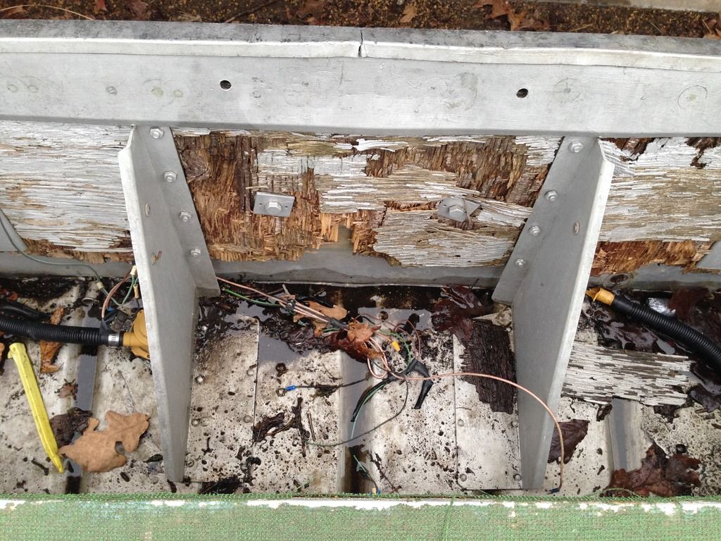

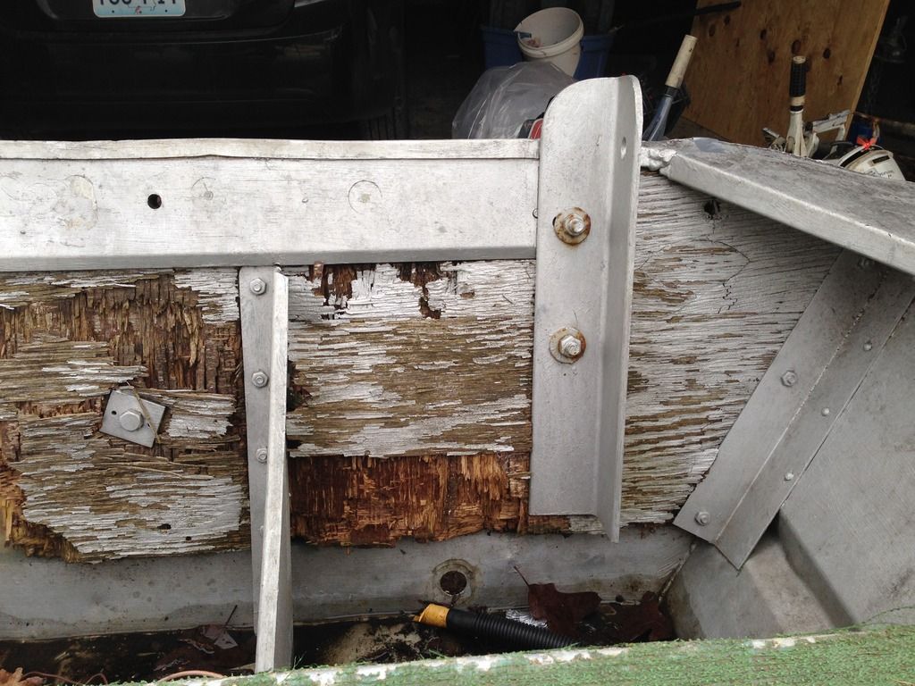

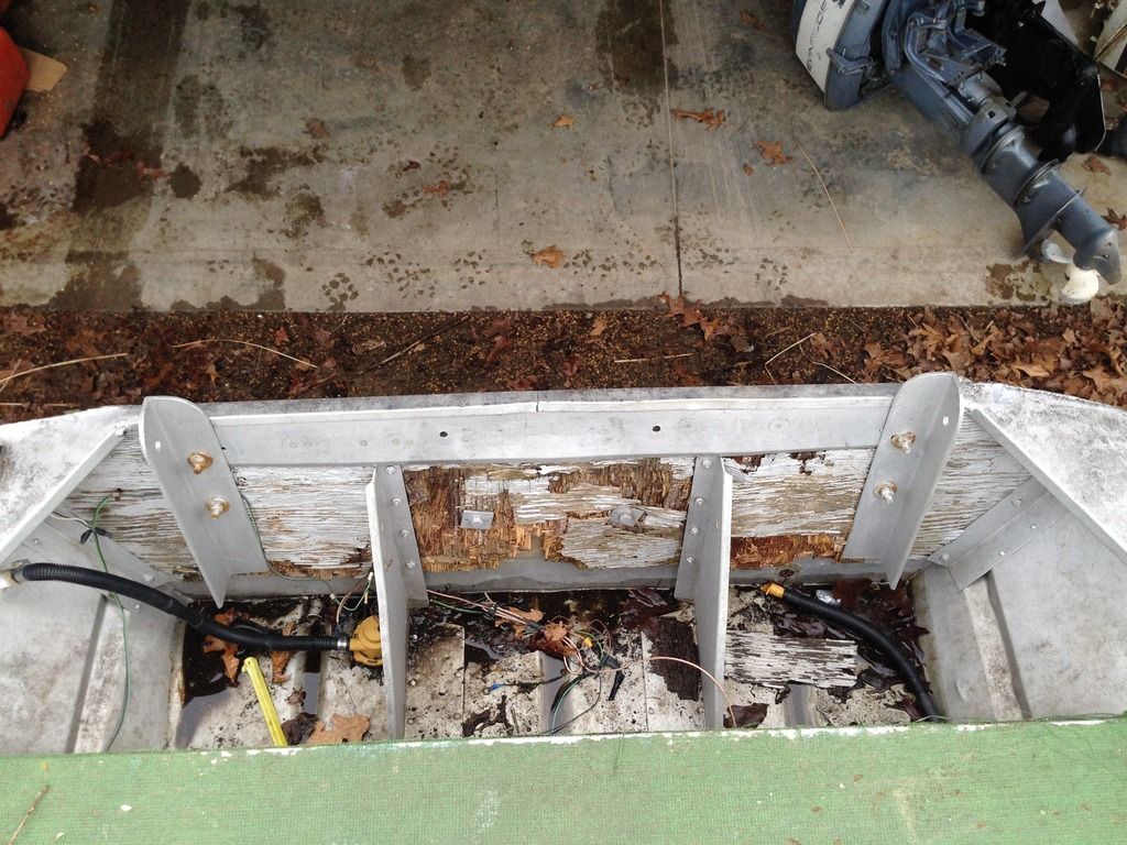

Okay it looks like I finally got photobucket to work for me. Here are some pictures to show you all what I'm working with. I'll post some pics of the entire boat tomorrow. The transom was one solid piece of plywood. It was so swollen/decomposed I'm not sure how thick it was. I've measured the gap between supports and the hull and its right about 1.5". I'll get some better measurements before I purchase the lumber.

I may be wrong but I'm thinking instead of removing the transom cap and corner pieces you could possibly remove the braces on corners that connect to the inside of the transom and the sides, then remove the knee braces, and the other support in the middle and pull the transom out by pulling the bottom towards you and then down from the top.
The corner pieces and knee braces look like they are riveted to the hull from the pics, and then simply screwed to the transom wood. If they are welded or if the rivets aren't accessible for replacement then my idea would probably be harder than removing the transom cap and corner braces and lifting it straight up and out.
It's hard to tell from the pics, but the transom cap looks like it's either part of the outer transom skin folded over, or is welded in place along the back of the transom.

IMO the cap(s) should not be cut.
Remove the knee supports and at least one side of the side to transom bracket. Bend up the inside of the top cap enough to slide or pull the wood forward and out. One corner will come out and move downward the further it is away from transom.
If able try and keep the wood in one piece to act as a template for cutting the new transom wood.
When you reinstall the brackets they will have to be fastened with new solid rivets or stainless hardware.

Totally agree. Again, NOT a Tinner but...based on what I see, removal of the knee braces etc and removing the wood my sliding it down and out appears to be the practical way to do this replacement. These members are giving Good Sage advice. Your transom is1.5" and the new one should be made to that specification. Take some careful measurements in order to duplicate it as closely as possible.

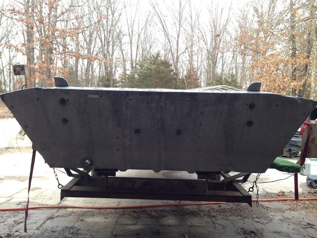

For those who wanted to see the whole boat
Another reason I'm considering having my friend come out and weld the caps is these cracks on each side. It looks like the previous owner went this route when replacing the transom with this wood.
