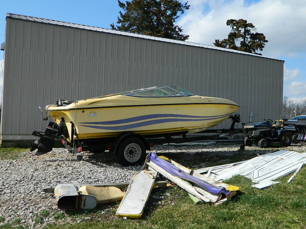

Hello All. My name is Jim and I have been a long time Iboats customer, but I am new to the forums. Last week I bought another boat, a 1995 Baja Islander 188. I bought this from its original owner that was in financial trouble and needed to get out of the payment. Instead of repossessing the boat, the bank offered a settlement of $790.00! My interest was purely in the very nice Eagle trailer that is under it for my other boat and part out the engine and drive to get my 800.00 back. But, when I brought it home the wife and kids really liked it and want me to fix it up, but we will save those details for the build thread.
Anyway, the boat has a 350 with a Alpha 1 Gen II drive. When I started looking it over real good, I noticed the numbers didn't add up. I called the previous owner (my interest was purely in the trailer when I bought it) and started asking questions. The boat originally came with a 4.3LX. That engine froze and cracked due to not being properly winterized around 2004 or 2005. They took out the 4.3 and dropped in a complete marine 350 out of a wrecked water patrol boat in front of the 4.3 drive. :eek: They used the boat for three years like this with a 25 pitch aluminum prop then it was put into storage till I bought her. The owner said the boat would run about 40 mph like this but I imagine the prop was flattening out from the torque and weight of the boat.
