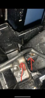

Great tip! So I’ve got everything put back together and put the boat on my water hose. Everything seems to be running fine. No leaks no overheating however there is water coming from an area where the shift lever is. Is this normal because I can feel a little exhaust coming from this slot. Should I be worried? I’ve attached a photo

Scott06
Apr 20, 2014
6,871
I do not think you should be worried the cause passage should drain this way intentionally
