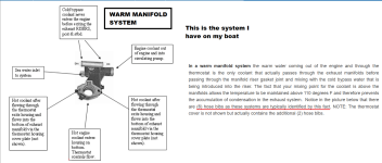

The thing with these warm manifold systems which looks like what you have; the elbows should be fed by a constant supply of cool water but the manifolds don’t get water flow till the thermostat opens. This is to prevent condensation in the manifolds by keeping the manifolds hotter than 120*F. Make sure the hoses are routed correctly, and the thermostat opens fully.

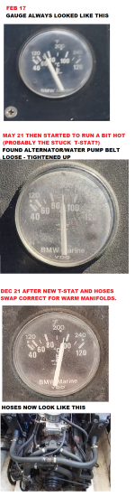

Below is recent history of the engine re running temps all taken after about 20Klm sea run (apart from last pic which is on trailer on muffs after approx 5 mins @ 1500rpm.)

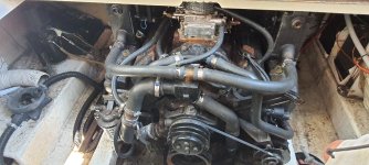

REPORTING BACK.
OK guys great suggestions thanks to all for your thoughts - today I changed the cooling hoses back to the way they were originally AND ENGINE RAN COOLER. Of course the hoses no longer send hot water to the manifold lower inlets, and the cool water is going up to the elbows. So the boat no longer runs a WARM MANIFOLD system so do I new get reduced manifold life via lower temps and condensation? If this is now the "correct" hose connection when using dry joints have Mercury dropped the warm manifold theory? Mechanic mentioned that my older style 6 bib outlet tstat housing water flow may differ from newer models with dry joints standard?
OBSERVATIONS
1. Engine ran at 185deg F on gauge (20deg cooler) jerked around a lot like the tstat was working, but it is rated at 140!
2. Cooling hose tstat housing to lower manifold inlets was quite cool and hose from tstat top outlets was very hot
3. Noticed hot water coming out of transom shield PORT side outlet like a kids water spurting gun but nothing out the STARBRD side (also a bit of a rust flake half blocking the PORT outlet hence the strong squirting about half a metre)
4. Could just lay my hands on the manifolds and elbows for about 1/2 second each
5. Still a minor amount of boiling and ticking noises after shut down
Tomorrow I may pull the main circulation pump though it has shown no signs of leaking or bearing noise. Or is it possible that my tsat housing with the 6 bib outlets is not compat with the dry joint manifolds? They did work OK at first with temp gauge showing 150deg F on long sea runs. Another likely culprit could be rust scaling slowing down the whole cooling flow? Don't really want to pull the manifolds unless all else fails. BTW I do not have any T-Balls on my tstat cover outlets?

OMCs and Volvos always had a cold manifold design and I don’t think that the manifold life was any different. The ones on my engine are exactly the same as what Volvo used from about 1994 all the way to the cat converter era. They do run cool; 90-100*F at idle the hottest they ever get is about 135-140 after coming off plane, and quickly cool down after that. I think OMC and Volvo used a 160 stat to reduce condensation with the cold manifolds set up. I don’t have this info from documentation but just a guess on my part. I did try a 140 stat because I’m in salt water and the 140 is supposed to be better in the salt but when I checked the manifolds after running at idle there was some condensation. So I went back to the 160 stats I have always used.
