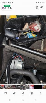

Thanks for you patience with me. Will have checked
