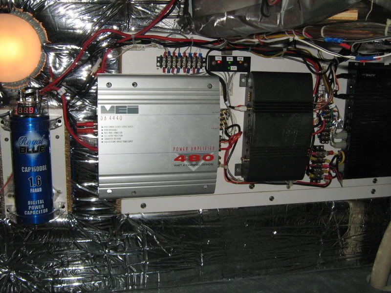

I've have these 3 amps and cap in my engine compartment, been there for 12 yrs and no problems, mind you it's a 35' express cruiser.
