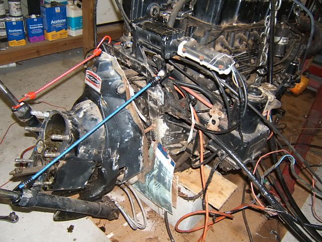

Here's some pics:
Here is the complete package I obtained:
When I say complete, I MEAN it! The guy I got it from actually cut it out of the boat it was in. You can still see part of the transom:

If I understand you correctly... You want to attach a pre-alpha drive to an alpha transom assy?
No.
But you should be able to mount the old style transom assy into the hole where the Alpha assy is.
I replaced the older style driveline, like the one you have pictured, with a Merc 454 and a bravo drive and transom assy. The bolt holes that were in the boat lined up, I just had to add a couple that weren't there, and I may have opened up the width of the hole by a little. Maybe 1/8".

No, I want to attach an old style inner transom plate to a newer style Alpha transom assembly. From the inner plate and inside will be the older 165 straight six. On the outside will be the newer alpha transom assembly.
I know the outdrive will work (I am familiar with the different length of driveshaft). I am just not sure if the two transom assemblies will match up with no hitches.
havasuboatman
Ensign
Mar 5, 2009
904
Re: Another "interchangeability" question
Now I get you. (Hit me in the head hard enough and I will understand!)
Yes, they should line up just fine. Look in Dons "adults only" section. He's got the Merc. Service manuels in there that you can look at and compare. Pay particular attention to the tiller arm and the trim lines.
