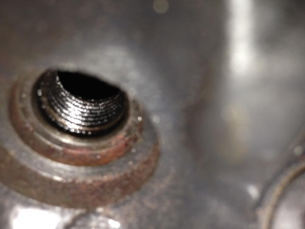

283
Re: Another spark plug question
Take a snapshot of the intake bolts and post it. Actually you might be able to get a shot with your cell phone camera of the plug hole at a slight angle, then you can just count the threads. If I look up plugs for 4.3 PNCA, both the injected and carbed version, on the Volvo Penta site they show a part number for the 24 pack thats the same as the plugs my 2000 5.0 Gi takes, and they are the long version (they dont list an individual number, only 4,6,8 and 24 packs). Do the bolts for the intake go straight up and down or are they at an angle that would match the head if the manfold was off?
(I think 96 was a transition year from the standard head to the vortec style head, I think the valve covers will fit either head, I'm not a GM expert though. If you cant figure it out any other way pull a valve cover and get the casting number from the head)

Well got a shot of the plug hole.
definitely looks like the short threads. I'm counting about 7 which matches the old plugs. So I guess I have a non-Vortec with Vortec covers.
Glad I noticed the difference in plugs and got the feedback from you guys that I did. Would've been bad news if I went and put in the long threaded plugs.
Thanks again as always.

Yes, That's a short thread plug hole. the AC R45T are a popular marine plug, they should be available just about everywhere, esp. marine centers. It's a great design with a fat center electrode (for strong spark), & it is alloy also, so won't rust out. I didn't realize how good they were till I started using them. I even used them in a slightly worked 355 74' Chevy Nova street engine.
By the way, Vortec, Schmortec,,, lol, Yes, you still have a Vortec V6, Chevy's been using, & improving this engine since it's inception,
