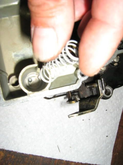

do you mean this spring and ball brg.? that's under the pump assy.?
this is the 2gc off my 72 mercruiser 165hp L6, i use it on my 75 mercruiser 165hp L6...
yes, i used them. it was called for in my service manual that cover my particular rig. don't know about yours. what do you have?

Thats what i am referring to. Its probably the same casting. I just didnt pull a check ball or spring out of mine. Just wondering if it needed the spring even though it didnt have one when i tore it down.
if it were my 75 mercruiser 165hp L6 i'd say yes, 72 yes. but we don't know what you have that carb. mounted on. what kinda engine/drive package do you have? i think someones sig here is, "just because you found it that way don't mean it's supposed to be that way" or the likes, this may apply in your case, but we still should know what ya got to help make a determination... i use the service manual as the guide to what i'm working on. that sping and check ball show up as being used. but like i said, that's mercruiser s/m #2 that covers my rig. we don't know which s/m applies to yours. the s/m is where you find the facts that would be for your application... myself, i'm no carb expert, so need to refer to the s/m...

Not really suprised about the check ball not being there because the rebuild instructions says to expect that on some. Its the missing pump spring that it doesnt show not needing. I am interpreting the instructions that it should be there.
Carberator tab 13765990A1
stamped on carb 17057132
1983 470 3.7L

looking at s/m #3. which refers to your carb. the return spring is necessary. the check ball is not used on later models. since s/m #3 is though 84, i would think you have the late model version. no check ball. but you do need the return spring... that's the way i interpret the instructions for your ring... info found on pp 4B17, s/m #3...

I agree...All of the 2GC carbs i have rebuilt all get the spring put back in.
Some have the ball and some didn't but the spring needs to go in.
