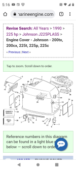

anyone know what year this looper is . no plate or welch numbers

It's a pre 1992 as it has water valve,3 piece air cover and old style trim. Cowling is not correct as states power steering and Oceans Pros are usually 25"

Faztbullet.thank you so much.we are getting there .I know 89 to 91 know with your information. This one has 2 screws on carb linkages 88 and older only has 1.i wonder if looking at anything else could get me closer on year..
