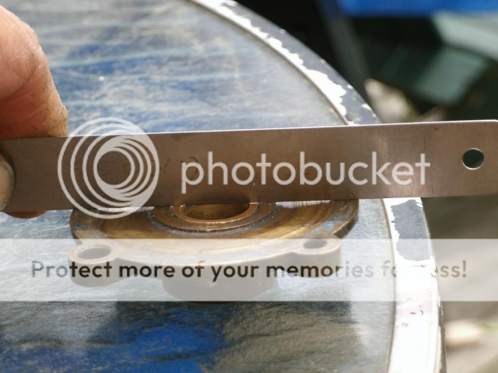

My 131C gave me problems for years, turned out to be a worn brass pump letting the water recirculate around the impeller ends.
I was surprised to learn that 0.020 was too much clearance on the face of the pump.

Yup the cam plate wearing out can cause a problem.
Not very often does that happen.
Usually motors with high hours or a boat used in shallow water.
Also the cover or the housing of the pump can be worn and not pump right.

Take the pump apart and take some pics of the cover(both sides) and the inside.
While the pumps off, take a hose and back flush the system.
