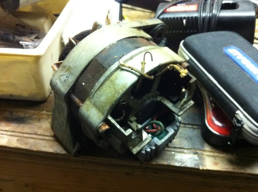

Hi, the Alternator on my AQ130D, has busted, i need to purchase a new one.. When i go to volvopentastore.com and search all i get is Replaced With "3580728" but everywhere I search that is just a Conversion Kit of some sort. Please provide some assistance... I dont have access to the part number of the one i have at this time, since i am at work but i will look it up when i get home. But like i said according to Volvopentastore it says that my part number should be 3580728...Please assist.

Why not get your current alternator rebuilt?
You know it will fit. It will support your local economy, and give a re-builder some business during the slow winter months. Probably far cheaper than buying an entire replacement from Volvo... ;)

Usually a lot cheaper, and they look like new when you get them back from a competent rebuilder. Look in your phone book for starter/alternator/electric motor repair.

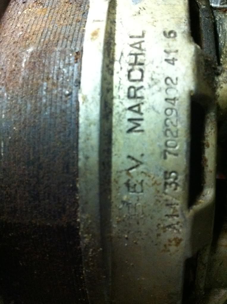

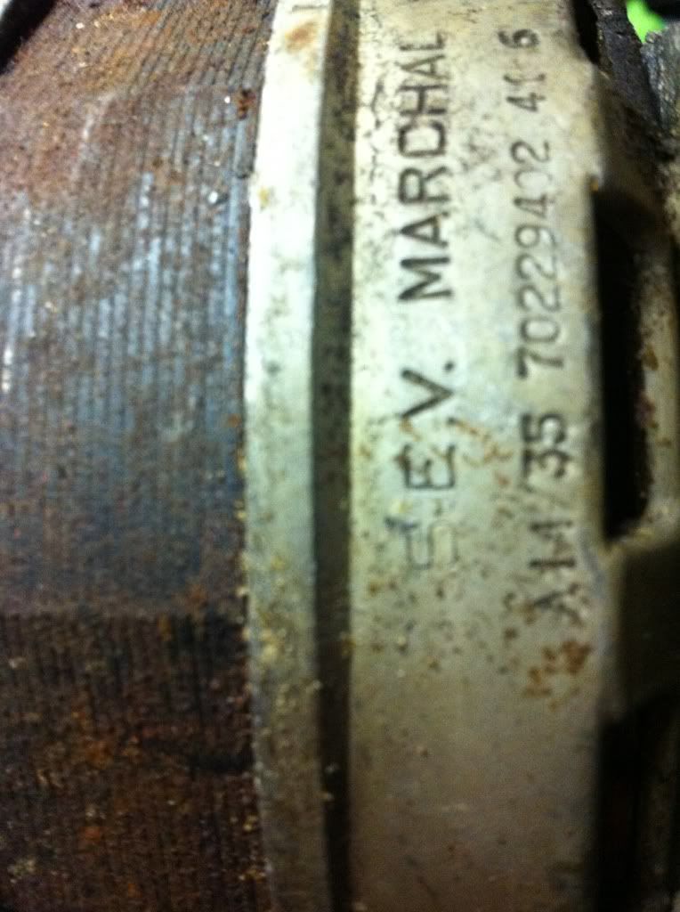

So the unit says its a S.E.V Marchall A14/35 (14 volt ,35 amp?)
70229402 41 6
I am wondering if this unit is past repair... and the repair shop said they would charge around 150-200 since its a old marine unit... and i dont know whether a new one would be the better option...
When i search for 70229402 under google i dont get much for the shopping option...
