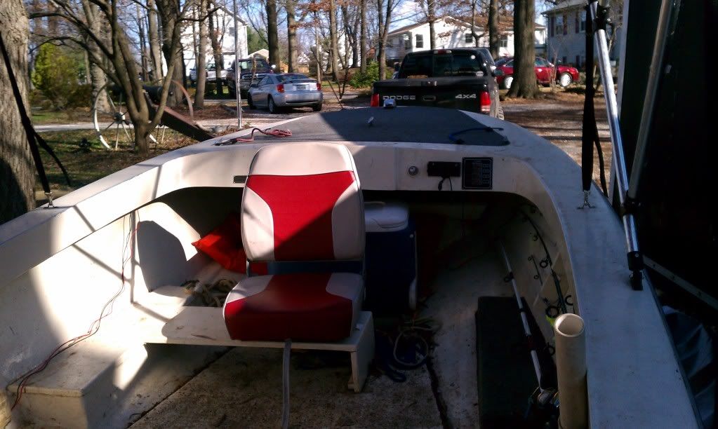

Thanks Zephyr, I would really like to see the readings. I ended up picking it up last night, and will dive into the motor later this week or after the hollidays. Right now I need to look for a steering application(either cable/pulley or teleflex style). Also I will need to know how to install all the wiring(to the battery and what not). I think I may repaint it to match the color of my boat. Since yall may want to see the boathere is some eye candy. I'll get some pics of the motor tomorrow.
