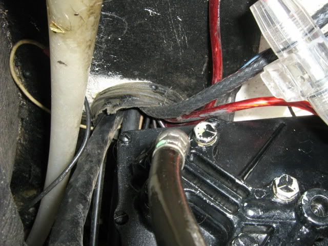

Found out the 21 is really a 19. Scott or Bill from Aristocraft emailed me and the throttle cable is 18' and the shifter cable is 16'. I can get a used "serviceable" one that is too long and will look to see if there is a way to loop it behind the starboard rear seat.
not much room behind where the cables come out of mj... this is where they exit inside the hull.. all the trim pump jazz is right there in the way. i find it hard to see w/o taking a pic of it... very recessed and back in there imho... :(
fwiw, i did manage to feed that red wire in. when i was doing that. i discovered, best i can tell. this tube is the only access between the passenger compartment and the engine compartment. only route possible to use to get things back and forth..

I thought there might be an open space behind the seat back, but I guess not. I will order a 16'.

When I changed mine I ended up just ramming them through the conduit. I pulled a line when I took the old ones out, but it ended up not working very well. As it turned out, I covered the clevis on the cables with a piece of hose and shoved them thru one at a time. I will be cutting an opening behind the aft seat backs to add back up plates for my swim platform project soon. I'll post some pic's when I get that done. I should be able to see the conduit routing the wire bundles/cables to the engine compt.
