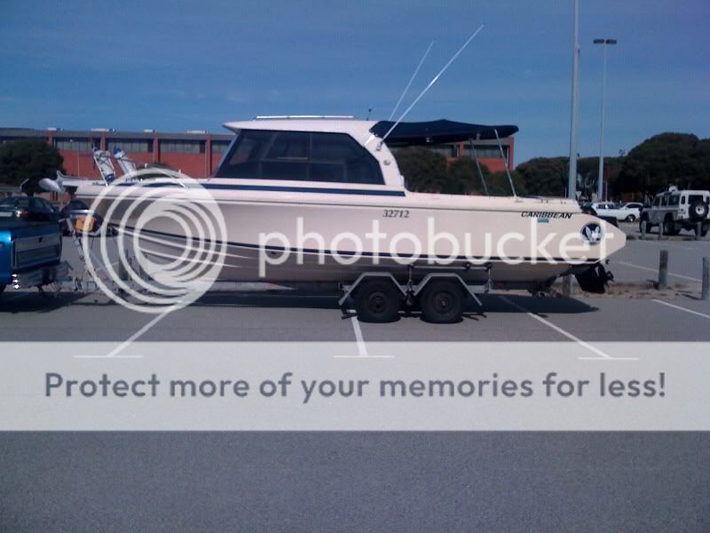

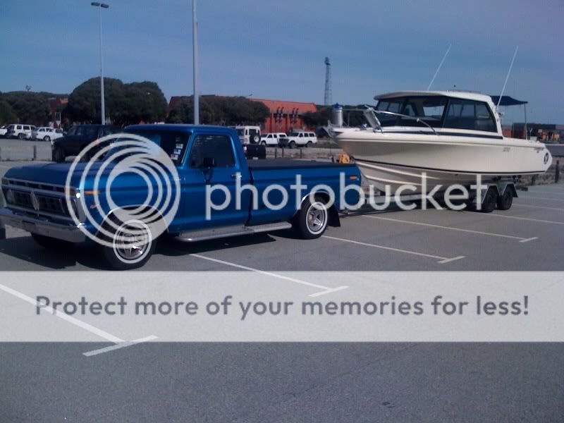

Hi everyone, have lurked on these forums for a long time and greatly appreciate all the info. I have a 16 foot glass runabout with 70 horse johnson (1994) but have just bought a mid 1970's-early 1980's Caribbean crusader 23 foot. It has a mercruiser 888 sterndrive (302 windsor) and has had the hard top extensively modified, raised with custom glass.

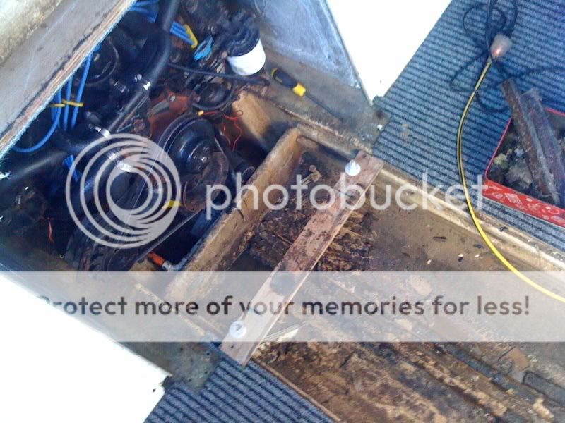

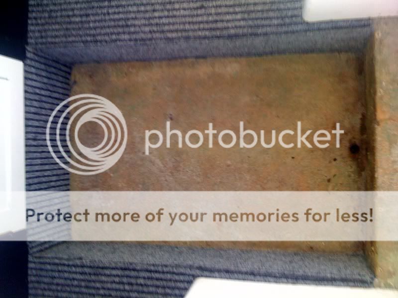

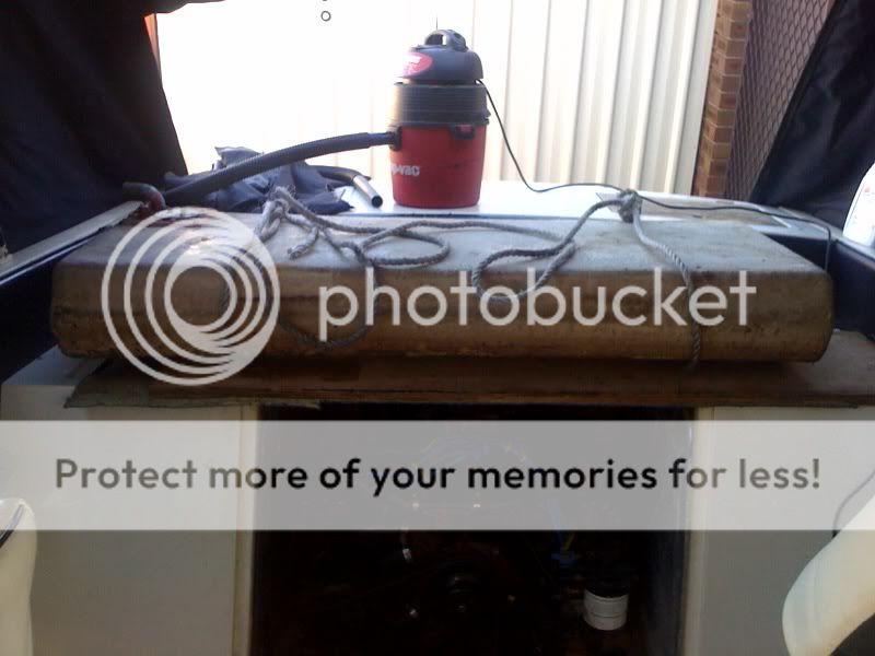

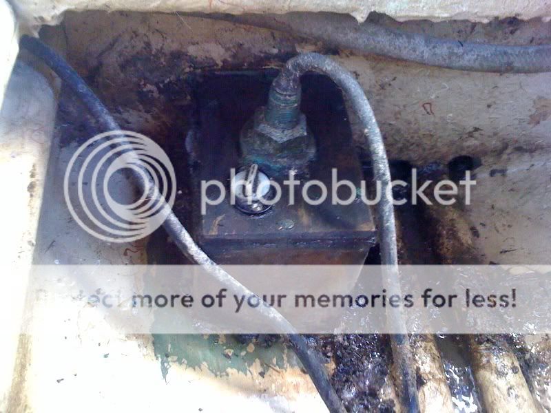

The boatyard left the drain plug in the transom and the boat has filled up with water. I have found a lot of water trapped in between frames and up forward. I have removed all the carpet and removed the false floor and fuel tank, to find a mess. It seems a combination of sawdust from a interior fit out, fibreglass dust and general muck have collected and been sitting for a long time, and mixed with water. The fuel tank cavity runs from midships aft to engine well, and i have completely cleaned this out and its in good shape.
From midships forward, the floor is sunk (lowered) and is ply sheet, glassed in. This forward section of floor consists of the V-berth floor, then a bulkhead, then the helm floor. This section of glassed-in ply foor has a cavity beneath it, maybe only a couple inches above the bilge. There are limber holes beneath this section of floor, but a lot of muck is trapped underneath the floor and its damp.
