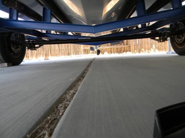

:mad-new: Ok this is the brand new axle went from square to round and the chamber on the axle is on top.
The distance from spring pads to end of the spindle is 15 inches I am now wondering if that is the cause of all my troubles. Most axles that are 95 inches show spring pad centers around 80 to 82 inches mine measures 70 5/8.
Trailer is 6 foot wide is this standard axle is #3500 Thanks for any help this is my third axle.:grumpy:

Is that a pre-cambered axle? If it is it's mounted upside down if it's not pre-cambered maybe you need one.

Yes it is cambered did mount it with camber on top. idle I also think it is to long of a distance from spring plates to the end of axle you can see axle ends are not straight. trailer came with boat had a boat builder tag on it but that does not mean some one did not change axle to what was on it. Right now face to face is 95" spring mounts are 70 5/8s from checking on thinks looks like I should have a 88" face to face measurement for the 70 5/8s spring mount measurement. Maybe I will have to raise the boat so wheels and fenders will clear so I can run the shorter axle on it.

that axle is WAY too long for that trailer..... YES that IS the source of your problem

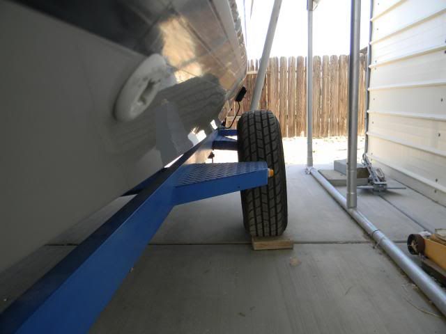

Look at the tire in relation to the fender mounts: It is sticking out when it should be a lot closer to the frame. The axle is WAY too long for the trailer.

For starters the overhang is too much. Maximum is usually 18" for most 3500 lbs axles.
Based on your information you have 25" so there is too much bending moment on the ends which will cause the bending you are seeing.
Visually it looks like the wheel should sit in between the steps on the trailer so the axle should probably be 10" shorter.
Is this trailer made for the specific boat? What is the weight of the boat and the trailer and how does it compare to the axle?

That tire can't come in to much more. When you put the fender on top it will be right against the hull.

Looks like a consensus. WRONG AXLE..

So someone either bought whatever was available or was misled by the sales person or a combination of both! Trailer axles do at times have a camber to them with the camber facing up. Causing the wheels to look like they are leaning out at the top. When loaded the axle flexes and causes the tires to run square, any good trailer shop would know this and explain it.
Sorry to say it but someone screwed up this trailer with an incorrect axle. Too wide, too much camber. This thing will wear out tires like mad and then someone will question why.
