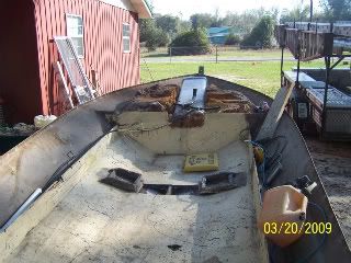

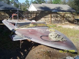

After a little work securing wires and dragging a engine hoist to the boat i finally got the top cap removed and it was easier than i thought, pulling the top half of a boat is way easier than i thought...here are some pics
i believe this is the longest gas tank i've ever seen
pretty clean
I saw another guys resto on a Baja and he cut the transom down to the deck and didnt go down any further, instead of cutting the deck out...the book i have recommends to cut the floor 24" back and take the whole transom out is this correct ??

Looks like you can replace the transom plywood without cutting the deck, but there could be something I don't see.

Well i was hopeful i would be able to cut above the deck and do it like that but...i'm not that lucky :D....here are some more pics i cut it about an 1 1/2" above the deck on the bottom and water started seeping out
